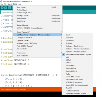

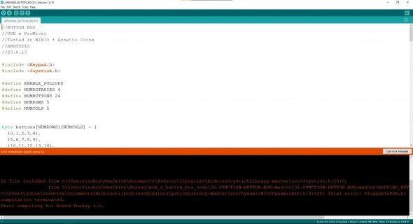

Arduino: 1.8.19 (Windows 10), TD: 1.57, Board: "Teensy 4.0, Serial + Keyboard + Mouse + Joystick, 600 MHz, Faster, US English"
In file included from C:\Users\zobie\OneDrive\Documents\Arduino\libraries\ArduinoJoystickLibrary-master\src/Joystick.h:24:0,
from C:\Users\zobie\OneDrive\Bureau\wim_s_button_box_code\32-FUNCTION-BUTTON-BOX-master\32-FUNCTION-BUTTON-BOX-master\ARDUINO_BUTTON_BOXV2\ARDUINO_BUTTON_BOXV2.ino:8:
C:\Users\zobie\OneDrive\Documents\Arduino\libraries\ArduinoJoystickLibrary-master\src/DynamicHID/DynamicHID.h:37:28: fatal error: PluggableUSB.h: No such file or directory
compilation terminated.
with these pictures you can see the arduino version, the librarys, USB type.

Not sure why you are trying to include a different library?
If you build with a USB type that contains joystick.
It will include the core file: On my machine, right now, that would be either:
C:\arduino-1.8.19\hardware\teensy\avr\cores\teensy4\usb_joystick.h
C:\Users\kurte\AppData\Local\Arduino15\packages\teensy\hardware\avr\1.58.0-beta2\cores\teensy4\usb_joystick.h
Depending on if I am using Arduino 1 or Arduino 2 builds.
Suggest don't include that library file.

First question is what library is this?
Is it the one https://github.com/MHeironimus/ArduinoJoystickLibrary mentioned in https://awesomeopensource.com/project/MHeironimus/ArduinoJoystickLibrary ?
Looking at their Readme you see:
This library can be used with Arduino IDE 1.6.6 or above (see Wiki - Testing Details for more information) to add one or more joysticks
(or gamepads) to the list of HID devices an Arduino Leonardo or Arduino Micro (or any Arduino clone that is based on the ATmega32u4) can support.
This library will also work with the Arduino Due, thanks to @Palakis. A complete list of supported boards can be found in the Wiki - Supported Boards.
This will not work with Arduino IDE 1.6.5 (or below) [COLOR="#FF0000"]or with non-32u4 based Arduino devices[/COLOR] (e.g. Arduino UNO, Arduino MEGA, etc.).
This library is not compatible with the underlying Teensy USB code.
That however does not necessarily imply you cannot update the code you posted to work with a Teensy 4
If you remove that include file from your sketch you will see some other error messages like:

And as the error messages imply, you should use button instead. More details about the Joystick code built in with the Teensy when USB type includes joystick
can be found up at: https://www.pjrc.com/teensy/td_joystick.html
