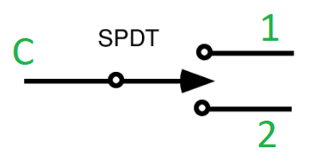

Assuming your toggle switch is electrically like this [with neutral position]:
If so, connect C to GND, 1 to Teensy pin 3 and 2 to Teensy pin 4. Then try the code below. BOLD is added code.

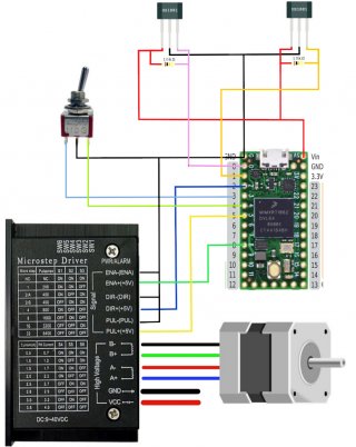

is this the correct wiring?
Looks OK, you have the controller connected in Common-Cathode mode [according to this spec].
What I'm a bit worried about is whether the output voltage of the Teensy (being 3V3 max) is enough to drive the stepper motor driver. The spec only mentions 5V or higher.
However, on this page, it states "Control Signal: 3.3~24V". So your milage may vary.

Yes that is exactly how it works. There are 2 end switches (I used hall sesors) in the origional code that turn the motor off when it reaches fully up or down. I tried using the dvr8825 drivers first but kept burning them up. Maybe not big enough heat sink. Thats why I went to the TB6600. I'm using a 24v battery, I don't know how many amps that motor is drawing but I suspect a fair amount for a short time. Anyway I have the drivers in a waterproof box with the heat sink on the outside and that has worked fine. I just need to replace the switch. I ordered a toggle switch, should be this here this week, then I can try the code. If it works then I just need to add the end switches. Thanks again.
I finally got to try this code for the toggle switch, it worked great! I haven't adjusted the speed yet, and I need to add these end switches. There are 2 hall sensors that should stop the motor when it reaches either end. I have a magnet on the assembly and when it gets close enough to the sensor it stops the motor from going any farther in that direction, but can still go back in the other direction, I thought I could just copy from the old code but I'm not sure I can because that one was wired common anode. Could you look at the code and tell me if it should work?

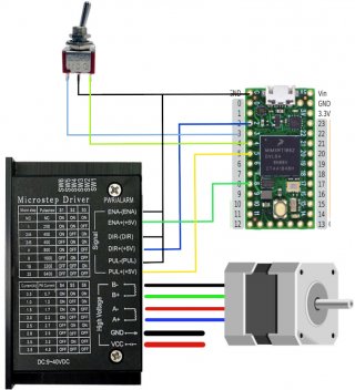

Caution: since a Teensy 4.0 is NOT 5V tolerant, you should not pullup the outputs of the US1881 hall-sensors with that 10K resistor to the 5V. I hope your Teensy is still OK...
Please remove the 10K resistors; we will use the internal pullups of pins 0 & 1. You need to power the hallsensor by 5V though.
Now to your code. I tried to compile it but it fails. Not sure why you wanted to use stepper library - we will generate all the required signals ourselves without the use of a library.
Also got rid of the ReadLimits() function. Reading of the hallsensors is done also when reading the switches.

According the hall-sensor datasheet, the sensor needs a reverse in magnet polarity to switch from HIGH to LOW or viceversa. This is a so-called latching switch. So it does not behave like 'normal' hall-sensor as in 'no magnet' means output LOW, 'magnet present' means output HIGH. You may want to search for another hall-sensor. Or just a reed switch.
But do you need the hall-sensors at all? I mean, you operate the switch manually up or down, so why not set the switch to the neutral position manually when the prop is at the desired position? Less parts is more reliable...
Paul
I'm sorry I just used a photo I found of the hall sensor, those are not the ones I used, I believe I used unipolar sensors they were not latching, they just kept the motor from running in that direction when in the presence of the magnetic field. when the field moved away it became active again. I would like to keep these for several reasons. I had issues with the old switch (pot) it would come on by it self sometimes I hope the toggle will fix that but I like the fact that I can hit the switch and know that it will shut off when fully up or down. I use it in the ocean and when I first go in or out I'm in the surf with a lot going on so I'd really like to keep these and the have worked well. I was hoping to be able to add condition to the code something like-
while (digitalRead(SW1pin) == LOW && digitalRead(hallsensor1Pin) == LOW) { // while switch is in up position AND hallsensor1 is not activated, send step pulses
digitalWrite(dirPin, LOW); // set up direction
honestly I don't know how to do that. This is how it was in the old code but it was wired common anode.

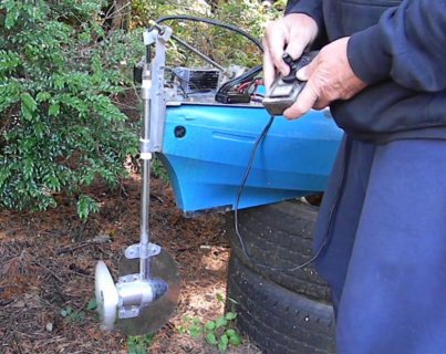

After watching the video, it is my understanding now that the Teensy will not only tilt the prop but also read the joystick and drive the propmotor and steer left & right. Is that correct?
If so, you may want to share the complete code to have a look at. Now I understand where pinMode(Analog_X_pin, INPUT); came from...
Are you using a Teensy 3.2 or Teensy 4.0? [wiring diagram shows a Teensy 4.0]
Paul
Thanks Paul, I'm happy to share anything I have but in the origional set up I used 2 nanos because they use 5v. I got the code from a youtube video and modified it (with some help) you may have guessed I have little to no experiance in coding. I tried to combine the codes and just use one board but I had problems and it was just easier to use 2 boards. They have failed several times, and I had a tennsy 3.2 and a 3.6 left over from another project, so I thought I could use one for the lift motor. I still use the other board for the steering and drive motors but this one has always been a problem. I may have used the wrong board for the illistration but it's a 3.2. If this turns out to be reliable, I can put the other motors on this board also, but for now I just need to get it back up and running again. I won't be able to work on it for a few days, I will keep you posted Thanks again
Thanks for letting me know the hall-sensor.
According to the datasheet the open collector output goes LOW when a magnet is closing in. And HIGH when the magnet moves away.
