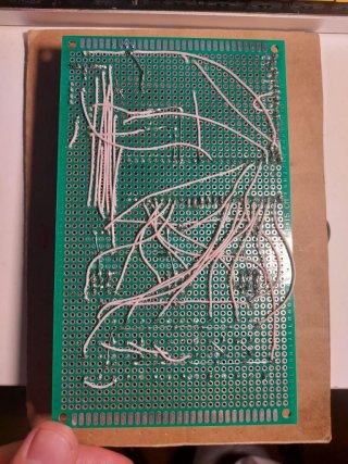

At first, i thought that it's maybe a software issue, that's why I decided to message you. Now I'm not that certain about it but maybe you or someone else can point me in a direction of the answer.
I have close to zero experience in EE and programming so this project is my way of learning it cause i find all this stuff fascinating.
Screen connected to teensy like it's described here https://www.pjrc.com/store/display_ili9341_touch.html only difference i swapped SCK pin from 13 to 14 cause led blinking was a little annoying.
I don't use Audio Adaptor Board, i use DACs (A21, A22) as output. As recommended i connected both of dacs through 10uF capacitors to 3.5 jack
Here i filmed a video with a noise:
Also here is how my board looks from the other side, maybe this mess can cause noise
Maybe, especially since it looks like the SCK pin for SPI runs right over the top of the two DAC pins, if I am reading correctly
Hello, I've made a couple of Teensy based synths. One with a ST7735 and I'm currently working on one with a ILI9341. Yes, the problem is your circuit board, which will radiate and pick-up the digital noise massively. I'm using a four layer PCB (one ground plane) professionally manufactured and cannot hear the noise from the display unless I turn up the volume on the external amp to the maximum. With better separation of digital/analogue and moving toward two ground planes, I reckon I can eliminate it - I'm a hobbyist too, basically. You could try a 100ohm resistor in line with the SCK line, which might make a difference or possibly not, but you won't solve this without a well designed PCB. Have you tried listening to the digital audio output via the USB?

Yeah tried USB output just before reading your comment, sound is clear there. Probably you are right poorly designed board is a reason, which is not a surprise)
Will try to add 100ohm resistor to SCK.
Also was thinking about to try output audio through PT8211 DAC, it uses pins 9,23 and 22 maybe it will help to reduce noise cause it will be further away from SCK

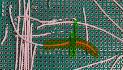

Again, I am no EE or the like, but some of the first steps I might try
As the two wires I sort of highlighted in green, I believe are the DAC pins, and they also have no insolation or the like.
The one in Orange I think is the SPI clock pin, which you ran right over the top of these bare wires.
What happens if you you move the orange wire, like bend it down a ways to avoid going over those two DAC wires?
If I had some shielded coax cable/wire, I would be tempted to use it instead of the orange one and maybe connect both ends of
shield to GND... Again not sure if that would help or not. Or maybe do that for the DAC lines.
Is the Audo circuit using GND or Analog GND? Does it make a difference?

You are right about the green wires, it connects dacs to a 3.5 jack, the orange one is a ground of audio input, its not active at this moment so I don't think it has any effect on a noise situation, but i will definitely move it to a different place in future.
Here is a SCK wire, highlighted by orange:
Definitely will try to use shielded wire for SCK, and maybe using it for DACs is also a good idea?
I tried both GND and AGND noise present in both cases.
