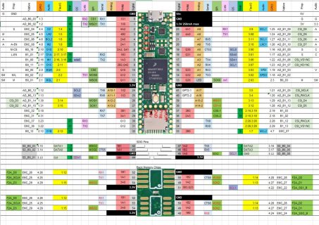

But should mention, that these only work on IO pins which are FlexIO pins. Which are shown in yellow in the picture in previous post:
in this like pin 2 is marked 1:4 (what this means is it is on the FlexIO1 object) and it's pin 4. As with other stuff this logical pin on that FlexIO object can only be used once if there are duplicates.

As I mentioned not all pins can be used for this. For example, pins 30,31 mentioned earlier are not FLXIO pins. The image I posted earlier shows which ones that are. Also the readme of the github project shows it as well.
Pins 32 and 33 are.
