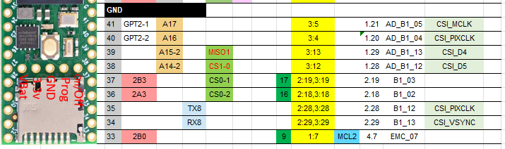

Looking at the pins involved:
37: is a chip select pin on the SPI object - It would only be used by SPI, if SPI.setCS(37); and again pinMode(37, OUTPUT); would overwrite that.
38: is a chip select pin on the SPI1 object . again only...
39: is an alternate MISO pin for SPI1 object. SPI1.setMISO(39). And again pinMode would overwrite that.
40: is not part of any SPI object.
