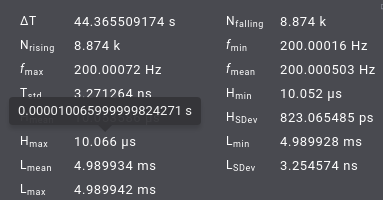

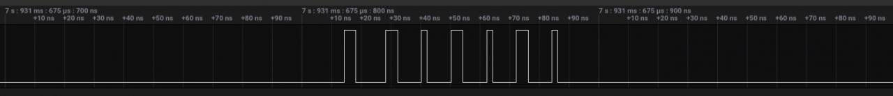

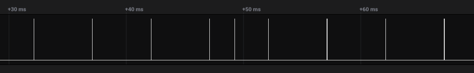

Debugging this has been troubling me a great deal now at this point. I've written a very basic script which polls in `loop()` to create a 200Hz square wave with 10us high time.

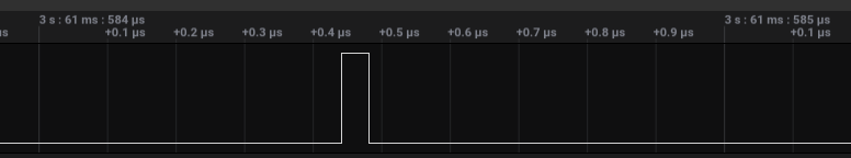

My logic analyzer (saleae logic pro 8) reports f_mean 200.000503 Hz with 3.27ns standard deviation for the first 40 seconds
after which this happens
zooming in on the spurious measurements reveals
This has really been gnawing at me, I simply cannot fathom how this could be happening with such a basic script. Cables are short and far from external, powered devices. So I figure it's not an interference issue. Pins are soldered to the teensy so there should be any possibility for movement. Note also, logic analyzer sampling at 500 MS/s

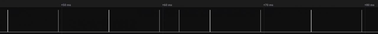

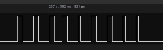

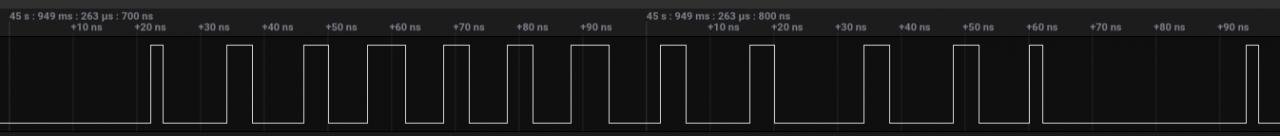

I set my logic analyzer to 25 MS/s (I couldn't choose 24MS/s) and got this
If I zoom in it's 40ns this time, but still happening
Note this happened after recording for approximately 3s.
It continues happening sporadically for the remainder (recorded 30 mins by accident) and the 4 I've explicitly zoomed in and observed were all 40ns, placed randomly between two normal rising edges.

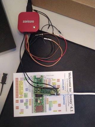

How different is my physical setup from yours?
I figure this has very limited possibility for interference as I've tried to route cables separately from one another, but at this point I really don't know.
Note, now I've tried to switch out the cable harness, switching to the other set of ports, and connecting the unused inputs to ground in separate experiments and all result in the same behavior. Think I'll try and find another logic analyzer and contact saleae because this seems to be very isolated to me.

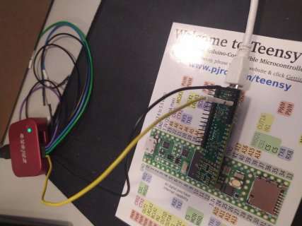

Your Saleae logic analyzer has 8 signals and 8 GND pins, one GND pin directly underneath each signal pin, for a good reason....
That's a lot better than depending on GND connection around a huge loop up one USB cable, through wiring inside your PC, and then back down the other USB cable.
But it's still considered poor practice compared to actually connecting GND to GND, where the GND wire closely follows the signal path.
Okay I see, thanks for the explanation. I'll try again and see what happens.
Note I attached a sensor to the output and it demonstrated weird behavior in the same region as one of these pulses. So it seems as though something may actually be happening here. Not sure why it's only affecting me however.
Tried again: Same behavior occurring very quickly after starting
Cables connected as recommended

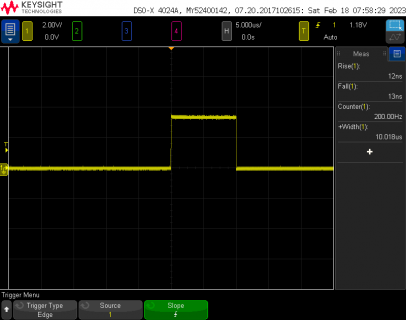

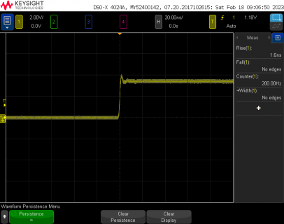

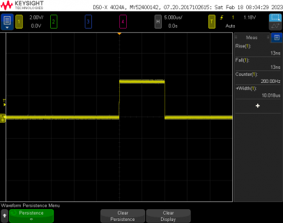

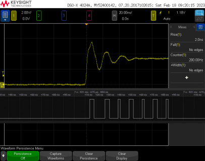

I tried the code from msg #5 on a Teensy 4.1 with my oscilloscope watching pin 2.
Here's a zoom in to just the pulse.
I put my scope into display persistence mode, so if the waveform changes the anomalous image will remain on the screen together with all other captures. Here's a result after running for a couple minutes.
Looks like the pulse really is the same every time, or at least so similar that variation can't be easily seen at this scale.

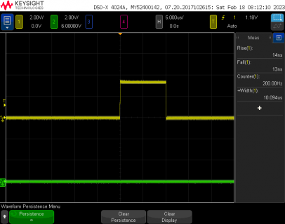

Tried again with the original code on msg #1. Connect scope to pins 1 and 2. Here's the result after a few minutes of updates in persistence mode. Can't see any significant variation in the waveform.
Ok, I'm looking at this closer (quite literally) because I'm just not willing to leave this at a simple "tried it, can't reproduce problem".
The first bad waveform on msg #16 appears to have a total time of 300 ns, and the second one appears to be about 1/3 of that. My oscilloscope sreenshots are 50000 ns total time, because I just ran the program and adjusted the settings to see the waveform.
I had set my scope to bandwidth limit mode. Actually it was already in that mode, as I almost always leave it in that mode, because it appropriate for quick measurements of relatively low bandwidth stuff. But this is looking at little pulses. My best guess from the image is 4 wider pulses look like 5 ns wide and the 3 smaller ones look like 2.5 ns. To really look at such short pulses, we need the scope's full 200 MHz bandwidth (or ideally even more, but 200 MHz is the oscilloscope I have...)
Here comes a look at 200 ns time scale, and some practical info about how to make these higher bandwidth measurements. For that part I'm going to have to get my camera....
It happens not so often, but it's quite repetitively a burst of rising edges between two normally spaces rising edges, as in https://forum.pjrc.com/attachment.php?attachmentid=30414&d=1676654125.

It's almost certainly a high speed signal quality problem. I will show you. But to really explain this requires photos, and more work to do than the quick low-effort measurements I made in msg #17, #18, #19. Maybe I'll later write a blog article about this (maybe) because it really is a difficult problem that's almost impossible to really see and understand if you're working only with a logic analyzer.

The peaks for me if I measure at full speed (500MHz) will come as 5 or 6 peaks with max 8ns width, something in this range. The signal itself is relatively consistent in this form. In another comparison above I attempted sampling lower (25MHz) to compare with @luni, this resulted in one HIGH lasting about 40ns.
Just to say I have been able to capture what I believe to be the same phenomenon with lower sampling rate.

Before I get into measurements, I need to say I still haven't managed to really reproduce anything that closely fits what you're seeing. So high speed effects may not be the entire story. But this message is about challenges measuring high speed signals.

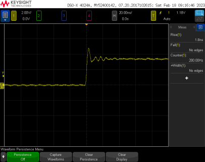

All the measurements in this message have horizontal scale total time of 200 ns (or approx 200 ns where I tried to overlay your logic analyzer waveform onto the oscilloscope screenshot).

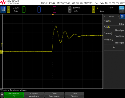

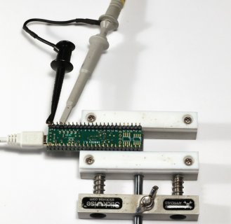

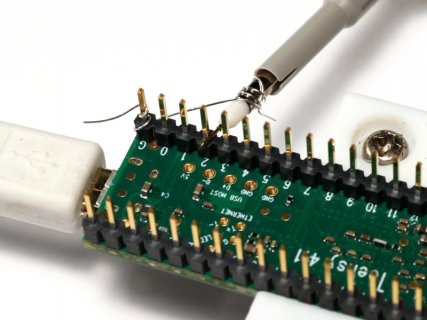

First, I measured with probe touching pin 2 and a small piece of wire directly from the probe tip to the nearby GND pin on Teensy 4.1. My scope has a spec of 200 MHz bandwidth, but I've long suspected they actually shipped about 300 MHz. The passive probes are rated for 700 MHz.

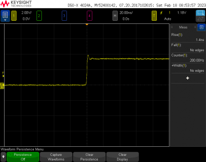

Here is the waveform my scope sees on pin 2.
Here is a run for about 10 minutes with display persistence. The fat glow around the waveform is the scope's noise accumulated over 10 minutes. Higher bandwidth means more background noise. But like the other persistence tests, the important point is we're not seeing anything else in the picture. If little 5 ns or 2.5 ns pulses were happening, my scope would certainly pick them up and render them onto this display persistence image.
The reason I almost always leave my scope in bandwidth limit mode is because the scope probe rated to 700 MHz really isn't good for more than about 30-40 MHz with the extremely convenient ground clip (this clip is not original from Keysight... I spliced on the Pomona Minigrabber).
Here is the result with the exact same test using the ground clip. You can see it adds quite a lot of overshoot and ringing.

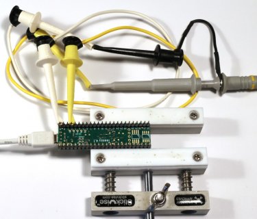

Now here is a third test where I added 2 clip leads (you can probably see I'm a big fan of Pomona Minigrabber). The idea was to try to see the difference extra wire length similar to the logic analyzer leads might make.
Here's what my scope sees with the extra wires added.
Now this isn't a nice match to the problem you're seeing. Your waveform started low and remains low after the pulses. So it could be some completely different problem. But look at the timing of the ringing due to the wire length matches up to the pulses your logic analyzer sees.
So at this point, I'd say the true nature of the problem is still quite mysterious, mainly because your waveform starts low and ends low. The ringing effect would start low and end high, or start high and end low if you caught the undershoot and ringing from the falling edge.
Unfortunately, the 2 take-away messages are rather unpleasant.
1: Logic analyzers turn ugly analog problems into pristine-looking digital pulses. It's too easy to think the problem must be something digital like software.
2: Tiny pulses under 10 ns are the realm of high bandwidth measurements where even a few inches of ground clip wire adds substantial overshoot and ringing.
