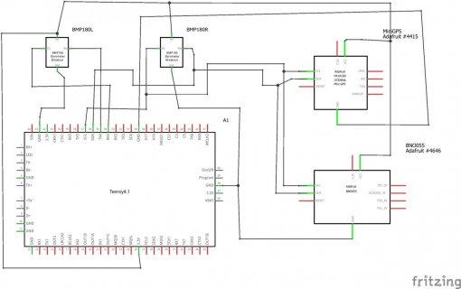

Adafruit MiniGPS not working correctly (Teensy 4.1)
I am trying to make this code to work and all other sensors work fine, but the GPS module shows:
Time: 00:00:00.000
Date: 0/0/200
Fix: 0 quality: 0
and after a while it shows like this:
Time: 16:08:14.000
Date: 19/2/2023
Fix: 1 quality: 1
Location: xxxx.xxxxN, yyyy.yyyyE
Speed (knots): 0.68
Angle: 15.35
Altitude: 280.10
Satellites: 4
but it doesn't update - time stays the same (I've changed location, but it shows the right one). I have the GPS module connected via I2C (the schematic is also included).
Here is the code I am using (all sensors combined):

So I want the GPS to output correct data, but I don't have ideas on what to do.
Here is the schematic:
Thanks in advance for all help.
Have you checked the I2C addresses of all devices to make sure you don't have a conflict? Since the GPS works by itself, structure your code so that you can add in sensors one at a time and see when it breaks.
you may need to add 2K pullup resistors on SCL/SDA to overcome the 10K pullups on each of the sensor PCBs -- I am NOT an EE :D
    @brief Read one character from the GPS device.
    Call very frequently and multiple times per opportunity or the buffer
    may overflow if there are frequent NMEA sentences. An 82 character NMEA
    sentence 10 times per second will require 820 calls per second, and
    once a loop() may not be enough. Check for newNMEAreceived() after at
    least every 10 calls, or you may miss some short sentences.
    @return The character that we received, or 0 if nothing was available
The library has this comment before the read() function. Your loop may be too slow when you include all the sensors. So maybe try a for loop of 10 reads instead of just one, or loop until c == 0 to get all the pending data.
Another observation, one of your bmp begin calls should point to wire1, as is I think you are reading the same sensor twice.
