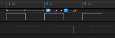

The program below produces a simulated quadrature encoder output on pins 2/3 and uses the QuadEncoder library to count on pins 0/1. This works at frequencies up to 18.75 MHz (150 MHz / 8), which produces 75 million quadrature counts per second. I suspect the quadrature counting will work at higher frequencies, but 18.75 MHz is the highest we can simulate with this method.
EDIT: this is over 100 times the frequency required by the OP.
The program sets up 50% duty cycle PWM on pins 2 and 3, then manipulates the flexPWM registers to shift (delay) the pin 3 square wave by 90 deg (25%) relative to pin 2. These pins were chosen because they are channels A/B of the same FlexPWM (4) and submodule (2). The image below shows the result for a 1-MHz square wave. The maximum value of 18.75 MHz implies a high time of 8 clock cycles at 150 MHz, so at this frequency phase B is shifted from phase A by just 2 clock cycles, and I think that's as low as it can go.
The encoder count is read from the callback of an IntervalTimer to get a precise 1-second total count. For positive count, jumper 2-0 and 3-1. For negative count, jump 2-1 and 3-0.
Note that QuadEncoder has many features, but if all you want to do is count pulses from an IntervalTimer ISR, you only need the minimal configuration calls shown in setup().
