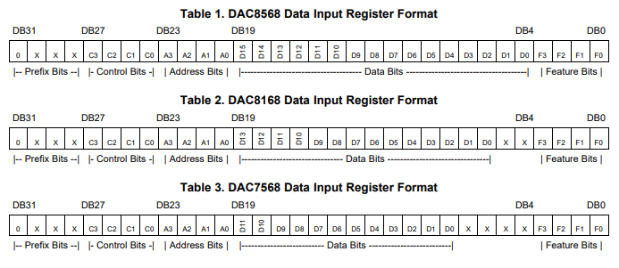

I am currently programming a PCB with a DAC8168 (8 outputs 14bits).
I found a suitable piece of code to program it.

But here is nothing is simple in life, the piece of code that I found is made for a DAC8568 (8 outputs 16 bits), either I just have a modification to make, however I have trouble understanding how it organizes the bits to create a 32bit message:(. Perhaps you could enlighten me on the subject?

The code example you found for the DAC8568 will work perfectly fine for the DAC8168 as well.
These DAC's are very similar - the datasheet states: "The DAC7568, DAC8168, and DAC8568 are drop-in and function-compatible with each other".
The only difference is the number of data bits, 16 vs 14 vs 12. Even if you write 16 bit data into the 14 bit DAC8168, the lower 2 bits will be discarded:
Page 35-37 of the datasheet show you the rest of the registers/commands that can be written - no difference except the number of data bits.

Hello, I have noticed that with the code you posted, for the RESET command you are sending
0x1c000000 = 00011100000000000000000000000000
However you would want to send
0x07000000 = 00000111000000000000000000000000
As you can see in page 39, Table 6, of the datasheet "DAC7568, DAC8168, DAC8568", it seems you are forgetting about DB29, and DB28, because on the 2nd place it says "DB30-DB28"
