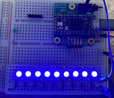

I am working on a project that needs lights and sound, after some research I decided to try a Teensy 4.0 with the Rev D audio board and some Neopixels.
I'm just at the stage of connecting bits together on a breadboard and getting some basic code running.
I am using a 74ahct125 between the Teensy and the pixels.
I downloaded the WS2812Serial - Non-Blocking WS2812B / NeoPixel LEDs Library and loaded and started playing with the examples.
After a bit of time i realised that the 7 pixels i had running seems to be updating slower than I remembered when using them with a Arduino.
I wrote some code that lights all the pixels at full red then dims it, from 255 - 0, without adding any delays.
The results were that my Arduino Nano is able to light and dim the 7 pixels around 8 times a second whereas the simular code running on the Teensy can only do the same around twice a second.
If there were and differences I would have expected the Teensy to be faster that the Nano rather than the other way round.
Is this some limitation on the non-blocking library or do I have a problem somewhere?

Well i've tried a few other things.
If i use the OctoWS2811 library the Teensy now dims the pixels and the same speed the Nano does.
I'm only going to be running a couple of dozen pixels connected as a strip so the OctoWS2811 would seem to be extremely overkill as well as using up a lot of pins I could be using for other things.
Code using the Octo library for reference.

Looking into this today. Indeed it is much slower. Tracked it down to this line in WS2812Serial::show()
        if (min_elapsed < 2500) min_elapsed = 2500;
I believe this is a leftover from the days when some WS2812 would do strange things if updated faster than their approx 450 Hz PWM rate. It limits the library from updating faster than 400 Hz. This limit can only come into play with short LED strips. With 74 or more LEDs, the 800 kbps data rate limits the refresh speed to slower than 400 Hz.
Maybe it's time to just get rid of this old limit...
works for me on simple set up with chain of ws2812bs, was 640ms a cycle now 130ms
typo on link above should be https://github.com/PaulStoffregen/WS2812Serial/commit/74c469ec35153639a6f9609c2e433bbf391c74c8
