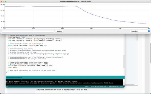

I'm rewriting my Processing simulation code for Arduino + FastLED. The animation runs fine and looks as expected - but is way slower than I'd expect on a small 16x16 matrix. I guess I made a silly mistake and I#m too blind to see it.
My guess was: Is it possible, that sinf() gets really slow with (very) large angles? I tryed to avoid it by using fmodf() before, but no change.
The (in my eyes) critical part of the code is here, it gets called for every single pixel:

It runs on a Teensy 3.6 with 256 LEDs at the beginning @240fps and drops within minutes down to 45fps with only 3 animation layers. Both numbers feel just not right. I suspect I do something stupid I'm not aware of. I use no lookup table for the polar data, because later I want to move the polar origin during runtime, too.

Frames per second over time

Found the problem, solved. FPS in the stable 400s now. Good.
Will explain the solution and final result when it's done.
Just a short video showing the current state. I reconsidered what is really required to calculate for each single pixel and what can be done just once per frame. Also fixed the collapsing framerate - sinf and cosf become really slow when fed with ever increasing angles.
