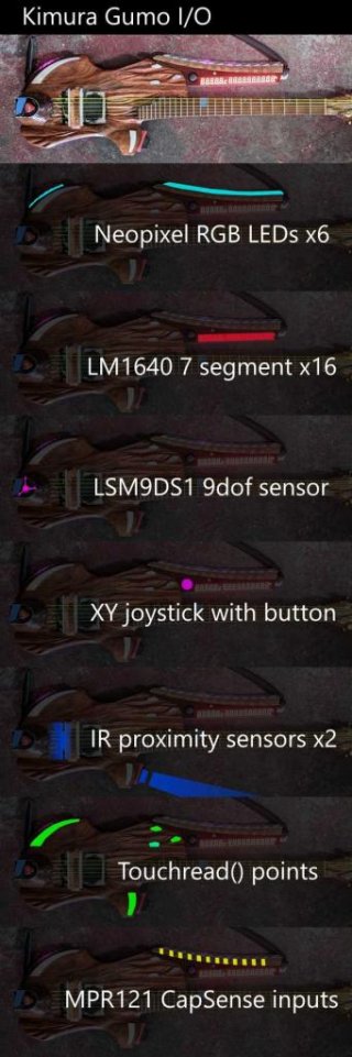

Hi everyone, my name is Andrew and I am looking for some help with programming this guitar, which I call the Kimura Gumo. I run an open source guitar company called Praxis Guitars. All of our guitar designs are available under Creative Commons licensing, and we are working to add open source digital controls to the instruments. We have an open source musical OS (debian fork) that we want to interface with. (you can check it out here: https://hackaday.io/project/170806-xpctos)
Currently I am working on the MIDI controls and visual feedback systems. These all run off of one Teensy LC. I have tested each system individually, but I'm not good at coding, and am having trouble getting more than one to work at a time. Any help with that would be greatly appreciated!
Here is a list of the systems:
Midi Out (pin 1)
6x RGB Neopixels (pin 5)
LM1640 7 segment display with 16 digits (I2C)
LSM9DS1 9dof sensor (I2C)
XY Joystick with button (X on A10, Y on A11, button on pin 14)
2x IR proximity sensors (forward on A7, bridge on A6)
5x Touchread points on the guitar (pins 3, 4, 17, 22, 23)
MPR121 touch controller with 12x inputs (I2C)
We've been gigging with it just running the MPR121 with some random blinken, and we're not particularly concerned with getting the display doing anything specific right now - we just want it to spit out MIDI data from all the various sensors. Generally speaking we've been using the MPR121 as a keyboard, and the rest as various CC values, usually aiming for the undefined CC #s. We've also discussed using the touchread points as latching on/off switches for the data from the 9dof and the two proximity sensors.

I've tested each system individually, but am not good enough at code to merge them together. Any help would be appreciated!
