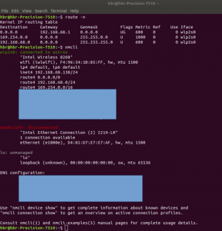

However in this second example the ethernet server is unavailable and I'm never able to access the web server. LED on magjack is green and flashes intermittently at first before eventually going solid.
Hoping I'm just using the wrong IP or gateway addresses and I'm not sure about the enp0s31f6 disconnected line shown below. Here is the printout from my terminal when I run
route -n
and
nmcli

Thanks!!

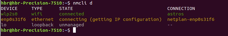

I also keep getting a popup that "Connection Failed: Activation of network connection failed".
It looks like my ethernet port is just unable to connect to the teensy if I'm understanding this correctly. Maybe it some type of setting on my laptop itself?
Is there a problem that I don't see an IP address associated with the ethernet port while the teensy is plugged in?
ip addr
returns the following
2: enp0s31f6: <BROADCAST,MULTICAST,UP,LOWER_UP> mtu 1500 qdisc fq_codel state UP group default qlen 1000
    link/ether d4:81:d7:e7:e7:af brd ff:ff:ff:ff:ff:ff
3: wlp2s0: <BROADCAST,MULTICAST,UP,LOWER_UP> mtu 1500 qdisc noqueue state UP group default qlen 1000
    link/ether f4:96:34:1b:85:ff brd ff:ff:ff:ff:ff:ff
    inet 192.168.68.138
