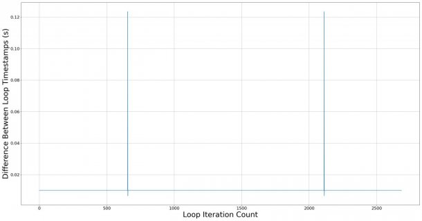

I have a T4.1 and I'm trying to do ~100Hz data logging to an SD card via the built-in slot. Even when running the T4.1 overclocked, I have inconsistent logging rates. Most of the logging is at 100Hz, but sometimes I get lags of up to 0.125 seconds! These lags are not evenly spaced through time. Even more odd, I also sometimes have a log rate of over 100Hz (not sure how that's even possible due to how I have my code setup).
The big question is: what is causing these timing issues (especially the lags) and what can I do to mitigate them? I understand that writing to a larger buffer (i.e. 512 bytes or so) might help, but I'm not writing much data per loop and 100Hz isn't that high of a sample rate. I don't think the SD interface should be struggling so much at 100Hz (IMO).

Also, here is the plot showing loop latency:
these high latencies are quite normal and within the specs and a couple of times discussed on this forum.
They are due to microSD card internal activities (bad block handling, wear levelling). In case you do not know, every microSD card has an internal CPU that is responsible for such activities, otherwise it would be be the user making sure that bad blocks and wear levelling is handled properly.
These latencies have nothing to do with the inefficient disk handling (100 times per second opening, closing files) which is only waste of energy, but a teensy could handle. To understand this you should know that microSD cards are ALWAYS accessed n*512 bytes at a time.
Way to handle this is to store data into a FIFO and writing from FIFO to disk.
To expand on WMXZs reply, the key is to break the link between logging samples and writing them to the SD card.
If you maintain that link then you need the write process to always finish in under 10ms. If you break that link then it will work as long as the SD card writes take less than 10ms on average.
As you've discovered the write times can be very variable, worst case write times can often be over 100 times longer than average write times.
The easiest way to break this link is to use a timer to collect the data and store it in a buffer. The main loop can then write from that buffer to the card as fast as possible.
Something along the lines of this should do the trick...

As indicated ideally the write function should write in blocks of 512 bytes. This would involve adding a second level of buffering at the write stage.
Alternatively if you keep the file open rather than closing and re-opening it every write then the file system will do this buffering for you.
The only reason to constantly close and re-open the file is if you expect power or the card to be removed unexpectedly. If that is the case then implement a counter and close and re-open the file every few hundred samples. That will limit your data loss to the last second or two while allowing the file system to do it's buffering most of the time. Ideally check that you have plenty of space in your buffer first before doing this.

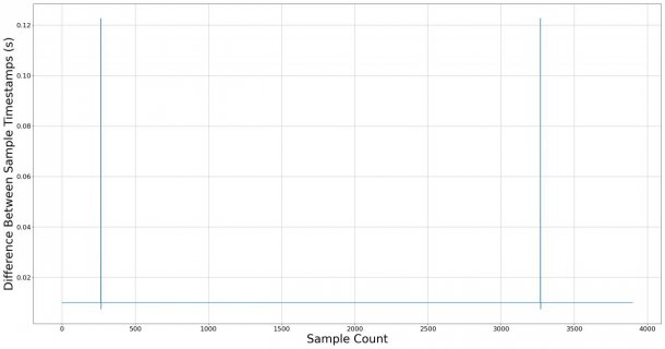

Dang, that's annoying/disappointing. Thanks for the info - I didn't know!
Thanks!
Dumb question: If I use an interrupt (which is what I assume `DataLogTimer` uses) to sample the sensors, I'm guessing I can still get the sensor data at a predictible rate during these occasions of SD latency?
Thanks!

Ok, that makes sense. Tangentially: is there an easy way to set interrupt priority levels? I'll need to do this for more complex projects
Ok, I gave the interrupt thing a shot. Here's the code:

It seems the log rate is much more stable, however, I'm still getting some 0.13s lag spikes. Am I doing something wrong?
Those larger lag spikes are normal as noted in p#2 and #3.
The SD drive can work at typical speeds for some time then the onboard processor 'does some housekeeping stuff' that keeps it busy for some longer time before it completes.
Doing writes in multiples of 512 bytes perhaps to 4KB or larger allows SD to consume and work with the data most efficiently. But it needs to be buffered expecting long delays to happen to loop[() code and data collection as done used with interrupts.

I changed it to an unsigned long and I still have the lag spikes in the sample timestamps, so I don't think it's rollover. Here's the code:

Here are the results:

I'm still looking for how to change the priority of a normal interrupt - is it even possible???
As others have stated, the key is to collect the samples and fill the buffers at interrupt time, then collect the buffers and write them to SD in the loop(function)
Thanks, however that's exactly what I'm doing (as far as I can tell), and yet still have the lag :(
Before you update and post, you should take all the Serial.print().. lines out of your OnNewsample interrupt handler. Serial.print() can take variable amounts of time depending on the response of the attached Serial device. That's not something you want to have changing the time in your interrupt handler. If you want timing stats, add a field to your output structure to record the micros() value at the time of response and examine and display it in the loop() function as you write the filled buffers to Sd.
Indeed, noted the removal of ill placed .print()'s twice - given the time value edit - that is possibly the cause as it would prevent timely exit and re-entry to the _ISR()
As far a interrupts - there are basically none but the two mentioned USB/millis tick. Any adjustment details would depend on what is added as the code develops.

Yes. The interrupt will interrupt the background loop and any lower priority interrupt.
I think others have already pointed out the big issue. As I indicated in my initial reply
// sample function. Called in an interrupt context so keep it as minimal as possible.
printf is itself a relatively slow bit of code and depending on the library used isn't always thread safe (meaning if you call it from an interrupt that interrupted something that was in the middle of printf then nasty things can happen).
Serial ports move at a glacial pace.
Doing both is not "as minimal as possible"
Store the data in the interrupt. Don't output it. Don't do any complex processing on it. Just dump it into a structure and leave everything else to the background task.
If for debugging reasons you need some indication that the interrupt is running then toggle an LED or output a single byte on serial using putc(). Assuming the port is idle or has space in the hardware fifo this will be a couple of register accesses and so not take any significant amount of time.
