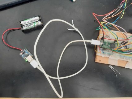

I am trying to make a standalone device using a Teensy 4.1 powered via USB using an Adafruit Powerboost 500 Basic attached to 2x AA batteries. When I try to initialise the onboard SD card with this setup, the Teensy stops responding. When powered from a PC or USB wall charger using the same USB cable, SD.begin works fine and the Teensy continues as normal.
I have examined the power output of the Powerboost and it is 5.2V, so unlikely to be a voltage issue I'm guessing. The Powerboost also allegedly outputs 500mA so that should also be plenty of current, although I have not tested this.

Program the Teensy with the following sketch using Arduino 1.8.19 and Teensyduino 1.56. It's a slightly modified version of the 'listfiles' example from the Teensy SD library, to which I have added some LED debugging, and removed the wait for the Serial port since no Serial communication would be possible when not connected to a PC.
Test 1:
Power the Teensy using the USB port of a computer, or a USB wall charger, and observe LED.
Result: LED flashes 4 times, then flashes each time it opens a new file from the SD card. This is as expected.
Test 2:
Power the Teensy using the USB port of the Powerboost.
Result: LED flashes only 3 times, then never flashes again after trying to run:
Any thoughts greatly appreciated!
