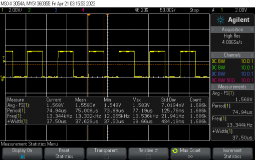

I have a bizarre timing issue with a project which uses the (older) Teensy 3.2.
I am using IntervalTimer to trigger a portion of my main code once every 100us. This part of the code sets an IO pin high for 25us (using delayMicroseconds()) and then sets it low again, before waiting for the next trigger (via a flag variable) from the IntervalTimer ISR.
When I run this with F_CPU set to 48MHz, it works fine. The period of the output signal is 100us and the high portion is 25us.
When I change F_CPU to 72MHz, however, the period decreases to 75us and the high portion INCREASES to 37.5us. Note that neither of these changes follows the ratio of the F_CPU change (I increased F_CPU by 1.5, the IntervalTimer period changed by 0.75, and the delayMicroseconds is executing 1.5 times SLOWER)
I am changing F_CPU in the Makefile. The main.cpp file is not changed at all between the two test cases.
I did notice that IntervalTimer uses F_BUS and not F_CPU, and in kinetis.h, when F_CPU=48MHz, it sets F_BUS to 48MHz also, but if F_CPU=72MHz, it sets F_BUS to 36MHz, which seems like an odd thing to do. In any event, though, I would expect that IntervalTimer and delayMicroseconds would both compensate for the F_CPU and F_BUS settings as needed to maintain the correct timing.
Any idea what is wrong?

Running at 48MHz:
Running at 72MHz:
I tested your your code and can not reproduce the effect. It generates a nice 10kHz signal with 25µs HIGH time for F_CPU = 48MHz, 72MHz and 96MHz
I think I know what is going on here: Looks like you compiled with -DF_CPU=48000000 which worked. Then you just changed your makefile to -DF_CPU=72000000 and recompiled without a 'make clean'. Thus the core was not recompiled (object files were newer than source files) and has still F_BUS = F_CPU = 48MHz compiled in. However, any code which uses F_BUS after you recompiled main.cpp will use F_BUS=36MHz. E.g. intervalTimer::begin will calculate the the required clock periods using F_BUS=36MHz but the timer still runs at 48MHz. Thus the actual period will be 100µs / 48 x 36 = 75µs which you observe.

Bingo! That was it! Thank you very much for your help!
