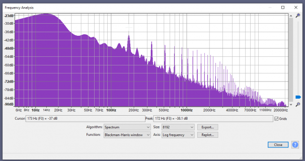

Hello all,
I'm new to the Teensy ecosystem and like many others I am trying to get the audio guestbook project off the ground. I've got demos of many of the other basic building blocks of the project working, and am now working on a recording demo using the MIC/GND pins on my audio board. However, when I listen back to the recording I hear a high-pitched whine overlaid on the entire thing. I've attempted a few things to get rid of this behavior, including:
  • Powering the Teensy using my 5V battery pack
  • Moving the Teensy away from my computer/other sources of electrical noise
  • Purchasing a USB-A to Micro USB cable with a ferrite bead to capture interference
  • Moving the microphone wires as far away as possible from the Teensy/power cord
  • Purchasing and re-soldering a completely new Teensy 4.0 & audioboard, as I thought my soldering job the first time might have been the issue.

MarkT,
Thanks for the response. I've selected a sample of the background noise in my recording in Audacity, and run the Frequency Analysis tool. I'm by no means an audio expert, so if there's a better way to do this I'm all ears. But it does appear that there is a peak between 16kHz and 20kHz. The peak appears to be right at 18kHz, which is pretty darn close to the 17.5kHz you mentioned. Any idea what could be causing the whine?
See the below photo:
Thanks,
Quentin

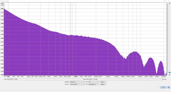

Use more FFT points, and set linear frequency scale, then you might be able to see better. The frequency of the spur may be dependent on system clock frequency and differ from Teensy to Teensy perhaps. Alas Audacity has a very poor choice of FFT windows, normally you'd use a flattop window for diagnosing spurs and peaks, but try Blackman-Harris.

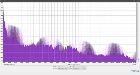

MarkT,
I've re-run the analysis using the Blackman-Harris window, size 2048, and Linear Frequency axis. If you'd like to take a look at the audio and do any analysis with your preferred tools, I've uploaded the file to the following Google Drive Link.
See the below photo for my analysis:
Thanks,
Quentin

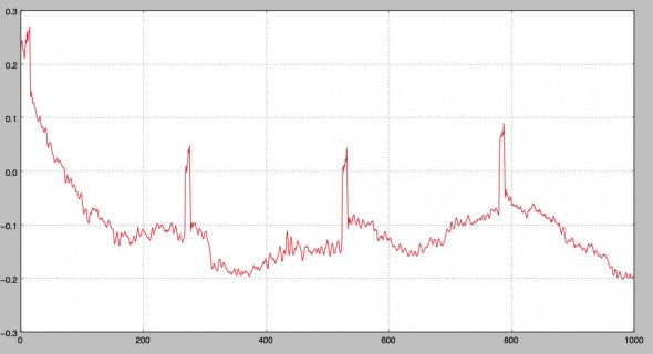

This looks like it might be the same thing I found recently - SD card writes draw a large current, and poor supply routing (and / or decoupling) results in power rail sagging which couples into the mic signal. See https://forum.pjrc.com/threads/70553-Teensy-4-0-based-Audio-Guestbook?p=325149&viewfull=1#post325149 and the following posts. In post #311 there's an image of where I added thicker wires to "star" the power directly to the SD card. I used 0.5mm (0.020", 25swg) tinned wire, it'd be better to use insulated. Note the wire connecting the two pin grounds and the mic ground, too: not sure it's necessary, but probably doesn't hurt. That was the first thing I tried, by itself it made a small improvement and was easier to do than the power wires which require identifying the SD card power traces on the PCB and carefully scraping the solder resist off.
If you look closely at the file you uploaded, you can easily see the SD card write spikes every 5.8ms, which is a fundamental of ~172Hz. Not quite what I'd call high pitched, but there you go...
Do let us know how you get on.
EDIT: here's my FFT from Audacity - I just looked at the middle section of audio, where you weren't talking.
MarkT,
Thanks,
Quentin
The problem is a spike of rogue values every 256 samples:
- that's just the first bit of the file. I suspect somethings overwritting the buffer[256] somehow?
[ Actually no, thinking about it its clearly that you've passed an evanescent pointer (i.e. buffer) to frec.write, but you have to pass a pointer to statically allocated memory to frec.write() as its non-blocking and interrupt driven. By the time the interrupt gets to use the buffer that stack frame is long gone and overwritten at the start, hence the spike. ]
Just tested that hypothesis, and no dice even with the buffer statically allocated. (As a matter of fact I don't think the SD filesystem is interrupt-driven, but blocks the sketch during reads, writes etc.)
Corroborative evidence to support a hardware issue, as suggested in my post #6 above:
  • with multi-sector writes, the fine detail of the rogue spikes shows a "spikelet" for each sector written
  • close observation of the leading and trailing edges always shows an intermediate-level sample; you'd expect a totally clean edge if it were buffer corruption
  • buffer corruption would have much more random values than those observed, which are just offset from the main waveform, and always in the same direction
Well it was a good theory (easily testable!) Sigma-delta DACs have complex reconstruction filters, don't expect the output voltage to be exactly like the digital samples (those leading and trailing edges). For that you need a different kind of DAC and no analog reconstruction filter after it.
