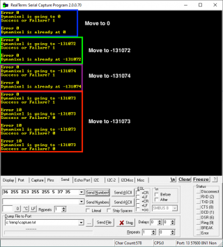

Thanks to both of you guys, you are most certainly correct that that code works fine without the Dynamixel stuff. Turns out, the Dynamixel stuff is the problem.

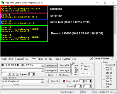

If I sent the Dynamixel to position -131072, it works just fine. If I try to send it to -131074, it works just fine, but if I try to send it to -131073 it sends correctly, and in fact moves there, but then afterwards the Dynamixel reports an Error 10, which according to the documentation is a DXL_LIB_ERROR_BUFFER_OVERFLOW error and sometimes and Error 12 which is a DXL_LIB_ERROR_WRONG_PACKET error.
I have absolutely no idea why this specific value causes this. Even sending the value directly in the code causes the same issue so it is not a problem with my serial parse code. I guess it's time to take this to the Dynamixel forums and see what they have to say.

Okay, further update, turns out I still don't know what I'm talking about. There is a whole lot of weird stuff going on here, I don't even know where to start. With my previous post above I modified the code a bit to add a case for $000000# and a case for #$111111#:

$000000# moves it directly to -131073 without any serial transmission of that position, it is just hardcoded in.
$111111# just reads the error and whatever position the Dynamixel is currently trying to move to.
Doing this still causes the system to fail but unless I'm doing something wrong, the error information does not get updated. It does in fact move the position, but then reports that it is at 0, without any error. Only when I try to send it to another position does the error info get updated.
