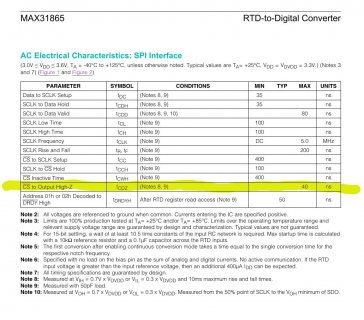

The MAX31865 seems to say the SDO pin does go high impedance when CS is high.
Still might be worthwhile to do the voltage divider test just to make sure MISO it really isn't being driven by anything while all the CS signals are high. But unless some other SPI device is connected, seems unlikely this is actual problem.

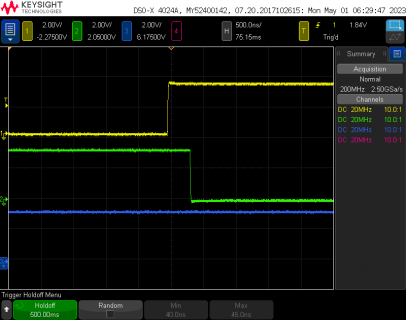

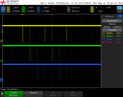

I ran the code from msg #1 on a Teensy 4.1 with no hardware connected, just to quickly look at the 3 chip select signals. Indeed it seems to be generating them on the 3 pins.
When I zoom in, looks like only 300ns from pin 8 high to pin 9 low.
Maybe this is fine, but as a quick and easy test, try adding delays before you read each sensor. I see inside the library Adafruit used delays of 10 and 65 ms, and they configure a slow 1 MHz clock. Perhaps these are pretty slow devices? Maybe such a short time is an issue? Just adding 10ms delays in the main program after attempting to read each sensor might be worth a quick try.
