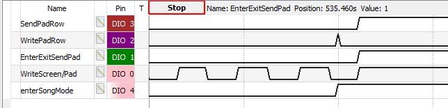

I busted out trusty logic analyzer (since I don't really have a good way to step through teensy code in a proper debugger ATM)
And did some digitalWriteFast's around all of the relevant pieces mentioned here.
I also wrote a version of the sendPadLights function without the clear vector call, from inside the switch in the note_on function.
I seemed to encounter the same issue, in a different way.
Signal Legend:
SendPadRow -> turns high right before AFControl->sendPadUpdate(padLightsToSend);, after the check to see if the vector is not empty.
WritePadRow -> High when entering WritePadRow function, low when exiting.
EnterExitSendPad -> wrapped around AFState->sendPadLights(); in main, high before and low after
WriteScreen/Pad -> high when 32mS has passed and we get the signal to write the screen, low 16ms after that when I plan on writing to the OLED screen
enterSongMode -> the button to start this whole thing off is pressed, and that midi note is sent. Basically, the "PATTERN_SONG" case in the note_on function above.
So, Logic capture with clear vector call:
When this happens, no sysex gets sent, and the teensy crashes / locks up.

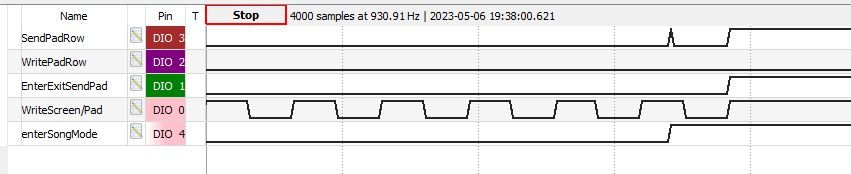

Logic capture with no clear vector call:
This time the vector did send the midi message, and the RGB lights did change, but the teensy still crashed / locked up.
You can see the blip on SendPadRow, it would seem that it send the message the first time without issue.
But, since the vector wasn't cleared, when the 30mS interrupt hit, the clearing function happened inside that interrupt call as above.

This doesn't seem to return anything. Maybe teensy isn't crashing, it's just getting stuck in an infinite loop somewhere? Or, if it's getting stuck in the ISR, It might not ever be getting to the "loop" section of code.
Nice to have the logic analyzer! Put a digitalWriteFast() around loop() to tell if it is running.
If SerMon is online and CrashReport isn't stopping to show info then the nature of the problem would seem to be 'stuck somewhere'.
