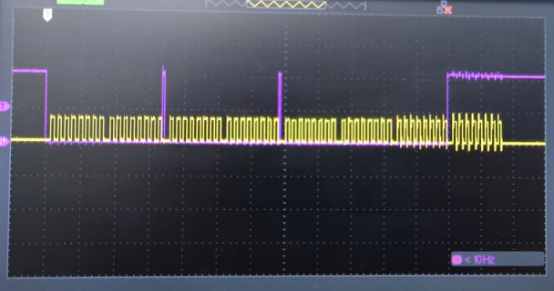

It works as expected but when I start to send out (high frequency) PWM signals on a, for the MAX31865, irrelevant pin, the communication stops working.
I connected a scope to the CS and SCK pins and made videos of both scenarios (with and without the PWM signal running in the background).
As you can see, one loop consists of two 2-byte transfers and one 3-byte transfer and in between the transfers the CS goes high as expected.
With the PWM signals running, the CS seems loose sync with the SCK over time. Looking at the code, this seems only possible if SPI.transfer() returns before the actual transfer has finished.
If I put a SPI.begin() command in front of each SPI.beginTransaction() this effect is somewhat negated but some data is still coming in corrupted:
I get that this has something to do with the PWM signals causing interference on the SPI lines, what I don't get is why this causes SPI.transfer() to return before the transfer is completed and why this effect worsens over time. My guess is that the SPI hardware is retrying a transfer after it detects something went wrong (hence the extra SCK bytes showing up sporadically on the scope) but this retry is not properly communicated to the SPI library.
If anyone has an idea on how to fix this in software or hardware, a reply would be very appreciated.

Odd. Note that its normally required to have some short delay after the last clock pulse before CS goes high, according to the datasheet of the chip involved. The T4 is very fast and explicit delays normally have to be added, even if only dozens of nanoseconds. Other slower microcontrollers may get the delays for free, but not a T4.
Thanks for your reaction. I added delayMicroseconds(1) before digitalWrite(CSPin, HIGH) to no avail. This doesn't seem to be a problem with the CS though, I tried leaving the CS pin HIGH during the transfers by removing the digitalWrites to CSPin, and see the same behavior on the scope where the amount of clock pulses is inconsistent.
I fixed it for now by implementing a software SPI solution based on Adafruit's BusIO code.

The Teensy4's SPI module uses both transfer and receive FIFOs (queues). The basic transfer() function pushes the argument (data to be sent) into the transfer queue, waits until the receive queue isn't empty, then pops data from the receive queue and returns it. That's how it's getting out of sync: somewhere along the way some extra data lands in the receive FIFO and transfer() starts returning before the passed argument is actually transferred. It does still get sent because it still gets queued, which is why you can still see it on the scope.
As for how/where the extra data in the receive FIFO comes from, I'm not sure. But here's a frozen frame from the "bad" video that tells a story:
You can see the first 2-byte transfer, the second 2-byte transfer, the 3-byte transfer... and then another byte transfer with CS held high. From that point on the CS line goes out of sync due to the receive FIFO containing more data than expected. I can't see anywhere where that extra one byte transfer could be getting queued.
