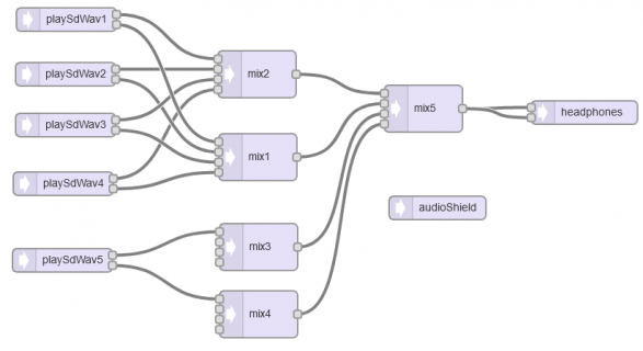

Update: So glad I posted this because obviously now I fixed it. I upped the audio memory from 10 to 12, which just introduced static noise when I was using a 3.6, but I guess the 4.1 has more memory? Anyways, it's all working now. :)
Hey everyone,
I'm building a super simple music mixer that has 1 button, 4 slide potentiometers, and 5 .wav files. When the button is pressed, all the .wav files will start playing. 1-4 will have their volumes adjustable on the sliders and 5 will be set to a constant volume. Everything is working right now except the first .wav file does not play.
It is easy to mix 4 audio files but in this case, I need 5, so I did this with the audio design tool:
(First I tried just putting the 5th track straight into mixer 5 but for some reason it didn't work. I've tried so many things but I got this to work until it didn't which is why I'm here.)
I'm printing all the slider values and can see they're all working. I've gotten this to work in the past few days but all of a sudden it doesn't work. All my wav files right now, ONE.wav, TWO.wav, THREE.wav, FOUR.wav, FIVE.wav, are the exact same file just renamed. They are 48.4MB, 1411kbps, and 4:48 minutes long. Again, only ONE.wav is not playing when I hit the button.
Here's the code:

AudioControlSGTL5000     audioShield;    //xy=1128,416
