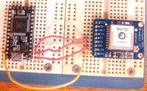

How it's wired up...
I commented out the "char c = gps.read()" line as suggested by Pete. (I now recall that earlier I had the whole thing commented out because now I'm back to what's shown below. I'm getting everything before the "if gps.fix" line, but nothing printed to the serial monitor after that. I was worried that I'd mucked up my library files by poking around them, so I replaced them with fresh copies. The only thing I changed was the case for the "isDigit" and "isAlpha" lines, so that the sketch would compile. Now I just get this. It is like the teensy just never gets the NMEA data from the gps, but I'm at a loss why not. Is there a very simple way to just print the raw data from the module, to see if I can get that far? The adafruit library contains a "blank" sketch for this purpose that just bypasses everything let the serial monitor print whatever comes its way. What would be the teensy version of this?

That photos really helps! I believe you need to swap the 2 signal wires. You've got RX from Adafruit's GPS connected to RX on the Teensy3, and likewise TX connected to TX.
What you really need is TX from one connected to RX on the other, and vice verse, so each side transmits to the pin where the other side is trying to receive.
Also, it looks like you've got VIN on Adafruit's GPS connected to 3.3V on Teensy3. That might work fine, and it's probably the safest way to use this. Adafruit claims this thing works down to 3.0 volts.
It looks like they put a 3.3 volt regulator on the board, meant to create 3.3V from 5.0V. You might check the 3.3V pin to see what voltage the GPS is actually getting from its own regulator. If it's lower than 3.0V, you might need to connect VIN to Teensy3's VIN or VUSB pin.
But swap those signal wires first. That will probably solve all your troubles.
Thanks so much for the help. It works just fine now after switching the serial receive and transmit wires as Paul suggested. I'm gonna chalk this one up to being a complete noob. Just in case anybody else stumbles across this thread in need of help, here's what finally worked for me.
