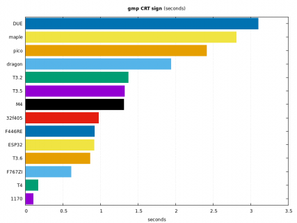

I just copied the .c and .h files from https://github.com/Cl3Kener/gmp/tree/master/mini-gmp into my sketch folder and was able to compile and run various big-integer tests. Big number arithmetic is the limiting performance factor in public key cryptography (RSA and Diffie-Hellman). I have some comparative numbers on various MCUs for calculating 100! with various multiprecision arithmetic libs. See
https://github.com/manitou48/DUEZoo/blob/master/perf.txt
The mini-gmp lib is much faster than the old Arduino BigNumber lib, but the wolfssl lib seems to be the fastest for the 100! test.
mini-gmp performance (microseconds):
     gmp         100!    DH       RSAs    RSAv   CRT     us    Faster
     T4            32   118834   596073   4674  167372  @600mhz
     T3.6         154   613554  3046753  23929  857665  @180mhz
     T3.5         244   942554  4633162  36401 1322092  @120mhz
     T3.2         253   971358  4714782  37047 1367517  @120mhz
     ESP32        269   649007  3199366  25175  913197  @240mhz -O2
     M4           277   949511  4694184  36870 1311418  @120mhz  SAMD51
     32F405       191   696230  3440666  27021  971729  @168mhz -O2
     F446RE       166   658182  3255084  25556  916767  @180mhz -O3
     F469NI       166   658188  3255096  25556  916778  @180mhz -O3
     F767ZI       110   436642  2171996  17050  607406  @216mhz -O3
     dragon       358  1383216  6785372  53320 1937244  @80mhz
     maple        529  2020175  9982062  78379 2808196  @72mhz  -O2
     DUE          503  2226100 11074698  87039 3098825  @84mhz  -Os
     ZERO/cpx    1171  4821906 23857807 187264 6716343  @48mhz  -Os SAMD21
     R4           713  2388621 11783349  92539 3301502  @48mhz  -O3
     pico         415  1739322  8682992  68165 2414692  @125mhz -O3
     1010          67   122292   605772   4759  605772  @500mhz -O3
     1170          57    75439   373023   2932  104778  @996mhz -O3 SDK
See wolfssl/mbedtls and RSAsign results here. We use the same 2048-bit RSA key as the wolfssl/mbedtls tests. DH uses 1024-bit integers.
