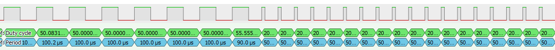

Hello, I'm using PWM_DynamicFreq.ino for generating 2 different frequency, What I'm trying to do is changing the delay between them around 1 to 10 ms.
I tried to do it with simple delay but it's not working for me. Can someone give any example for it?

I will try to explain better. The delay I need is between the 2 signals, to get a "0", for 1 to 10 milliseconds.
Its not working with 1 second delay between.
Please see the result that show that first frequency is ended and the second one begin immediately.
If "0" means "no signal" for 1 to 10 ms, here is an example that seems to work. It repeats this cycle:
  • for 10 ms, frequency=1000(Hz) and duty cycle=50(%)
  • for 5 ms, frequency=1000 and duty cycle=0 (no signal)
  • for 10 ms, frequency=500 and duty cycle=50

Thanks, I thought that I tried it before and for some reason got an error , But now it work when I set Duty Cycle to 0.
I have another question regarding it, How I can get the delay time and also the time when there is frequency more accurate in nano seconds?
