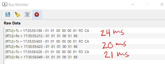

Hi All,
I've been working on a project where the circuitry allows for either Ethernet or Serial connectivity based on a jumper position. The code is essentially identical between either mode of communication, the only difference being some ternary operators set up to make sure I'm addressing the correct server:
I'm using QNEthernet and ArduinoModbus libraries.

In the attached images you can see how my Modbus testing software (QModMaster) is sending a request to read the value of the coil and the time it takes to get a response. The results are a bit faster in this simplified code, but still pretty slow on the ethernet front.
EDIT: made code blocks cpp for clarity. Also, I can ping the Teensy and always get <1ms response
Thanks for taking the time to look at this!

A couple of things I noticed at first glance:
1. There's no need to specify a MAC address on the Teensy 4.1 because there's a built-in one. May I suggest using the begin(ip, netmask, gateway) function instead? As well, the one you're actually using in the code you pasted is begin(mac, ip, dns). See: https://www.arduino.cc/reference/en/libraries/ethernet/ethernet.begin/ (I don't love the Arduino Ethernet API for these things.) (This is the one you want if you really must specify your own MAC address: Ethernet.begin(mac, ip, dns, gateway, subnet))
2. I would use if (client.available() > 0) instead of if (client.connected()). I think that's the real intent. (You could even experiment with while (client.available() > 0) because that will be false when there's no data.) The Boolean check just checks if connected. The connected() function checks if connected OR if there's still data available, or both, so it will always be true as long as the connection exists OR there's data, or both. The available() function checks how much data is available, even after disconnect (similar to connected()).
This link may also help: https://github.com/ssilverman/QNEth...ce/README.md#how-to-write-data-to-connections
Basically, QNEthernet's client send functions don't send data until either a short timer expires, until there's enough data for a packet, or until flush() is called on the connection. It looks like the place where that Modbus library is calling write() is here: https://github.com/arduino-librarie...3a4f1331dc8/src/libmodbus/modbus-tcp.cpp#L202
Try changing to something like this:
C++:
size_t retval = ctx_tcp->client->write(req, req_length);
ctx_tcp->client->flush();
return retval;
(Note: I haven't tested this.)
Let me know if these tips help.

Wow Shawn thanks! This is a lot of info. I get a little bewildered with the lower level stuff, I tried my best and here are the results...
1. You're right, I didn't need to specify Mac address, so I updated the variables and call to begin() such that it uses the fields you suggested. I'll have to change some things in my full program to use the IPAddress datatype, but no big deal. This didn't help the speed, but it does make the IDE complain less about deprecated overloads. I was just copying the examples from the modbus library, so I'm happy to bring things up to date. Thanks!
2. I changed to if (client.available() > 0) in my loop. Again, this didn't help with the speed, but I do like to know I'm doing things in a more preferable way.
3. Updating the call to the write() function in modbus-tcp.cpp#L202 made a HUGE difference. I was getting an average of 150ms reply time in this test-code, but only about 2ms average after the change. Unfortunately I'm getting a [ Class "Client" has no member "writeFully" ] error when trying to implement the further correction you suggested... I think I get the intent here, but it seems that the call isn't looking in the right place. "Go to Definition" takes me to Ln 256 of QNEthernetFrame.cpp, but I don't see a writeFully() in that file.)
I'm a little nervous about trying this fix with just write() because of the potential problems you mentioned. But it does work with this single coil example, so I'll try it on my full program just for kicks.
Here's the current code, and the change to modbus-tcp.cpp is exactly as you suggested above with write():

Alright, new day! Yep I was looking at that, but couldn't quite figure out how to fit it into the code last night. Again, I'm not great with this low level stuff. But I tinkered with it this morning and I think I was able to get the same functionality cobbled into modbus-tcp.cpp#L202. Here's what I changed it to:
C++:
    // return ctx_tcp->client->write(req, req_length); // Original line 202
    size_t retval=0;
    while (req_length > 0 && ctx_tcp->client) {
        req_length -= retval;
        req += retval;
    return retval;
This seems to work just as well as your original suggestion (no errors, and <3ms return time with my full program running 40+ registers and 20+ coils.)
I'm assuming the above code is doing the job of writeFully(), but I'm a little unsure of how I declared retval=0 in case the while() never happens. Does this look like the return will always be correct, or should I declare/order things differently?

Yeah, I expect it to be about the same speed. It’s just the proper way because write() may not send all the bytes requested of it. Since you’re using something like Modbus, I’m guessing that reliability is important to you.
Yes, it looks similar to what writeFully() does under the covers. Check out the library source code to confirm.
As for the library using QNEthernet, because I made EthernetClient conform to the Client interface included with Teensyduino, it shouldn’t matter too much. It’s just that that Modbus library could stand to be a little more robust when using Client::write() (actually Print::write()). It’s in the Arduino API docs that write() returns the number of bytes actually written; that’s why it needs to be checked.
Thanks Shawn,
That was my concern... Since write() may be called more than once in the loop but only returns once I couldn't quite gather if the way I have it is returning the correct value. It does seem to work, but yes indeed reliability is important, so I didn't want to jump to conclusions. I did do my best to duplicate the source of writeFully() in this new location.
I'll keep playing with it, but I think I'm up and running. Ethernet is running faster than Serial(9600) again. All is right in the world ;)
I just added an option to flush after all write calls. Other than the issue of write() not actually sending all the bytes (eg. because of internal buffers and such), just setting this new option in qnethernet_opts.h should duct tape the original issue (again, assuming the write() packets are small enough). Note that it might not matter for, say, the Modbus use case, it might affect TCP performance for other use cases. The new option: QNETHERNET_FLUSH_AFTER_WRITE

Hi Pedro,
I'm no expert either, but my project did end up working out nicely. A big help in troubleshooting was to have a known-good modbus program on my PC to test my Teensy code. I used QModMaster (https://sourceforge.net/projects/qmodmaster/) but there are probably a dozen such programs that you could use.
By using a software like this, you take out any guess work as to which side you might need to troubleshoot. Once you've successfully tested your Teensy code, you can develop your Python code with more confidence.
Also, I changed my RS485.cpp to use Serial5 for Modbus communication. This keeps the Serial.print() commands from interfering. Not sure if you've done the same, or if that's even an issue, but I always try to keep my diagnostics communications separated.
You can also remove the delay(1); since you're not setting up any inputs in your code.
