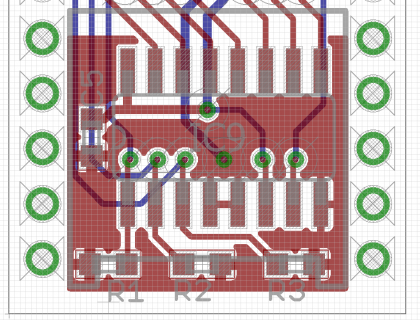

Hi everyone, I would like to extend RAM on the Teensy 4.1 to make a four channel looper.
I would like to make a new version of Frank's board for the APS6404L-3SQR-SN 8MB SPI memory chip with 8 chips on it.
I am currently using Paul's CS42448_T4_TEST2 board.
https://oshpark.com/shared_projects/gVFy0fWQ
Looking at Frank's memoryboard4,
https://oshpark.com/shared_projects/KZt5PaU7
it looks like these two boards can be stacked, with Frank's board using pin 7 for MOSI and pin 12 for MISO on the Teensy 4.1. I guess this is possible since I think someone earlier in this thread tried it. If so, it seems to me the new board should use the same SPI pins to minimize confusion.
To use eight memory chips, all eight outputs of the 74LCX138 need to be used. This brings up the question why Frank put the 74LCX126 on memoryboard4. Can/should it be removed to allow two more memory chips on a new board?
Thanks
Doug
While I have little experience with the audio capabilities of the T4.1, this thread does raise some interesting questions about memory management. The one that intrigues me the most is whether it would be possible to use a file on the SD card of the T4.1 to hold the audio data for later playback. With a bit of care with buffer management, it should be possible to pipe several channels of audio to the SD card for later retrieval as the echo output.
A key question is whether a single file can be open for writing by one process and open for reading at a different location by another process (Like a Linux pipe??). If that is not possible you would need to alternate between two files, one for reading and one for writing. At appropriate times, the files would switch (easier said than done, I suppose!)
Hi everyone, here is the first draft of the Teensy 4.1 memory board with eight SPI memory chips.
The MOSI and MISO connections are different than Frank's Teensy 3.x version, which seems to me to be necessary for the 4.1
I removed the 74LCX126 buffer to obtain all eight output pins on the 74LCX138. I am not sure why the buffer is there.
I didn't add the pulldown resistors on the digital pins DO2, 3 and 4, but perhaps I should. Is there a memory corruption concern on power up? Perhaps pulldowns are just best practice here?
Comments and critiques welcome. My aim is to piggy back this onto Paul's CS42448_T4_TEST2 board.
https://oshpark.com/shared_projects/gVFy0fWQ and record four channels of audio.

Frank is still around, as mcu32 - maybe he’ll pipe up?
If I were you I’d try to track for fitting pull-downs (you don’t have to fit them), and maybe some links to change the device selection lines from D2 to D4 to other pins.
If you make enough boards I’d be interested to test one and add support to the library.

I added locations for the pulldowns.
Can you please clarify "links to change the device selection lines." Is this just a naming thing, like I should use C0/C1/C2 instead of DO2/DO3/DO4? If so, I agree. Or are you talking about moving to different pins altogether?
Once this comes together, I will post on github and run a few copies with Osh Park.
I was thinking in terms of having the option to use different pins as chip select. D2-4 are also I2S2, so might well be wanted for an audio project. There aren’t many pins on a Teensy 4.0 that can’t be used for some audio function or another, but a 4.1 gives a few more options.
Please let me know when you’re ready to run and the likely cost of a board or two, plus shipping to the UK. I can populate them myself, bare PCB is fine.
Great, thanks. One point that’s just occurred to me … as it is there’s always one PSRAM enabled, so the SPI bus can’t be used for anything else. That wasn’t an issue with only 6 of them, of course, as there are a couple of unused addresses.
The 74LCX138 has three pins E1,E2,E3 to enable/disable it so that more memory can be added to the same SPI bus. I did not bring them out to the board pins though. It's easy to do in the next rev, but it would consume more digital I/O.
It turns out that all the CS lines must be able to go high because leaving one low by default corrupts the memory on that chip. I have broken out pin 4 on the 74LCX138 to Teensy 4.1 pin 5. Setting this HIGH sends all the CS lines high.
It appears I am able to run this board successfully at 60MHz SPI clock, although maybe I am jumping to desired conclusions.
Project has been updated to R1 on github and OSH Park.
The 74LCX126 is for level shifting, because Teensy3 is 5V, the memory chips are not. It's not needed for Teensy4.
I am building a memory expansion board that's shorter so it fits on Teensy 4.0 footprint (also 4.1 of course) and has (6) 23LC1024 chips. It uses the same memory addressing scheme as the original Teensy 3 Memoryboard so hopefully it'll be recognized by the libraries.
