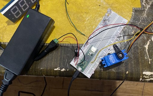

I am also attatching a photo of the hardware. I think I have it all correct. I have an external power supply, connected to a Capacitor, to the vin and ground from the teensy, to the power and ground from the servo. And pin 9 from the teensy is connected to the signal of the servo.
In the Arduino software I have USB type set to : Serial + MIDI. Maybe I have the wrong serial speed? Is that something I need to specify in the code?
If anyone can see something I am overlooking please let me know.

Hey @thebigg. Your solution worked!!!
I had a feeling it was something super simple like that. I would have never guessed that, but it totally makes sense to map the value to the position.
Thank you so much for spotting that.
