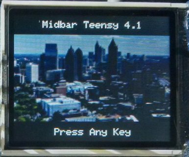

Greetings, everyone.
It's been a while since I last released a Teensy-based version of Midbar.
I am excited to announce that Midbar (Teensy 4.1 Version) V3.0 is finally out!
Midbar (Teensy 4.1 Version) V3.0 has a smaller and less expensive display than the previous Teensy-based version of Midbar, more optimized code and a couple of new features.

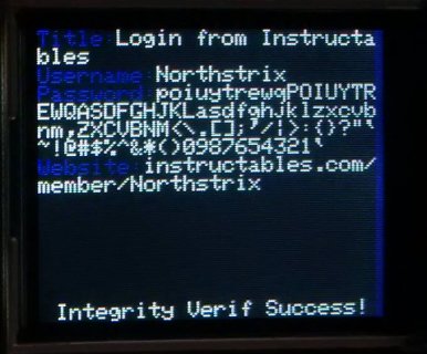

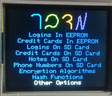

This version of Midbar incorporates a password vault, credit card vault, phone number vault, note vault, encrypted book reader, data encryptor/decryptor, and data hasher.
Aside from the fact that it can function as a USB keyboard, Midbar comes with lots of convenient features, such as:
  • USB keyboard support - Allows you to interact with Midbar using the USB keyboard connected to the Teensy 4.1 USB port;
  • Combination of EEPROM and SD card storage - Enables you to store 16 login credentials and 10 credit card details in Teensy's EEPROM and allows you to store as many records on an SD card as there's available space on it (as long as you adjust the value in the "#define MAX_NUM_OF_RECS 999" line of course);

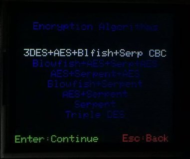

  • Sophisticated encryption with integrity verification - Midbar utilizes a 3DES + AES + Blowfish + Serpent Encryption Algorithm in the cipher block chaining mode of operation combined with the HMAC-SHA256 to encrypt your data and check its integrity;
  • Data Encrypter - Whether you're going to use the keys that are partially derived from your master password, or encrypt a string using the key you enter on the USB keyboard, Midbar got you covered. You can encrypt a string of up to 10,000 characters using any of the available encryption algorithms;
  • EEPROM integrity verification - The Midbar checks if the EEPROM is tampered with each time you unlock it;

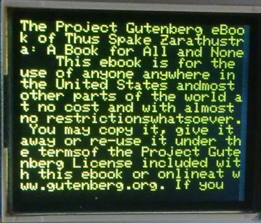

  • Encrypted Book Reader - Enables you to read books encrypted with Serpent encryption algorithm in CBC mode.

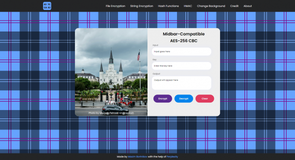

The string encryption software compatible with Midbar (Teensy 4.1) V3.1, Midbar ESP32 CYD, and Midbar ESP32-CYD Firebase Edition is now available as a web app.
Check it out in the "String Encryption" -> "Midbar-Compatible AES-256 CBC" tab at https://northstrix.github.io/React-Cryptographic-Toolkit/
More information about the encryption scheme can be found at https://medium.com/@Northstrix/react-and-cryptography-creating-my-own-toolkit-40944af4d534 under the "Implementing the Midbar-Compatible AES-256 CBC" headline.
