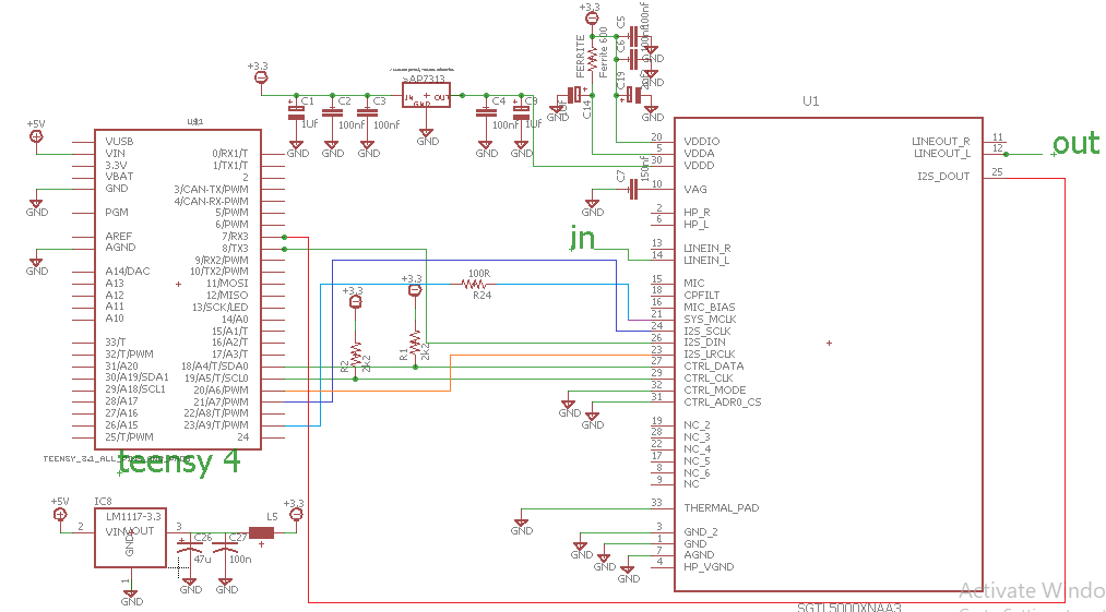

Hi All!
I'm sorry to start a threat about this... but i'm having troubles to make an stgl5000 pcb i made for my personal needs to work.
I'm aware there are new I2S connections and i believe i did them right.
In the past i did two sgtl5000 for teensy 3.2 without any problems, but it's not working on teensy 4.
Below is a simplified schematic of my board, teensy 4 is running fine (All I/O's etc) i just cant talk to the sgtl...
I used an eagle footprint of the 3.2 but matched (i believe) to teensy 4 pins and added some color to the connections.
Can anyone spot any obvious errors?
