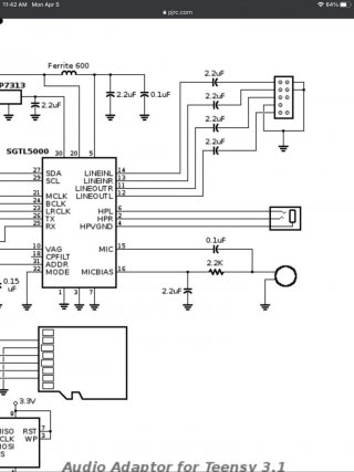

Been reading this thread, since I also plan to hook up a handheld dynamic mic (eg.Shure SM58 or similar).
Why couldn't I just use the mic input on the audio board to connect it to?
The mic input on the teensy audio shield is designed to allow easy use of common electret condenser capsules.
The mic input on the audio shield isn't just an audio input, there's a biasing source.
Definitely rather noisy, dynamic mics are low impedance and a good mic preamp is needed to get a good
noise figure - otherwise there's little point moving to a professional microphone in the first place. And without
a differential input the EMI/hum pickup would be an issue.
