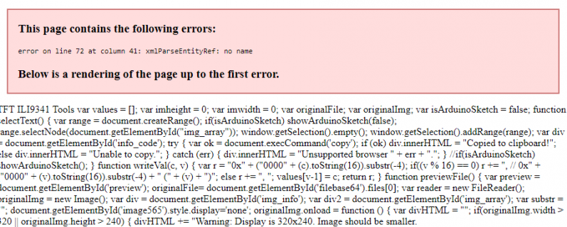

To use the converter, you can check my webpage (it is pure JavaScript, nothing will be uploaded to the server):
http://www.petrucci.ch/arduino/tft.php
