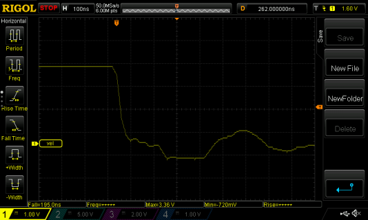

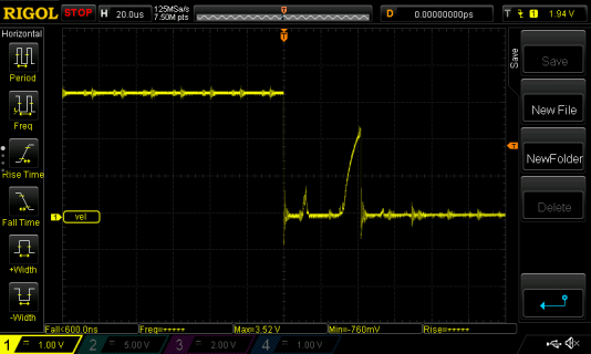

The problem I'm having is with the anemometer. The anemometer is conventionally constructed, with a rotor that spins as driven by the wind. The anemometer is connected to its peripheral station by two wires to form a normally-open circuit that is closed briefly once per revolution. A closure rate of 1 Hz corresponds to a wind speed of 1.492 MPH.
At the peripheral station, one of the two wires from the anemometer is grounded, and the other is (a) pulled up to 3V3 through a 10K resistor, and (b) connected to digital pin 24. An ISR attached to that pin, triggered by a falling level, counts revolutions, and conventional code does the rest.
The problem I'm having is that the system worked as designed for half a day or so, but then the anemometer events stopped being recorded. The hardware & software were not deliberately changed in any way, so I have some fear that an electrical problem has fried the Teensy's D24. Again, substantially identical code was used with Arduinos with no problems; that is why I think I may have inadvertently exceeded the dynamic tolerance of the Teensy.
The signal coming in to the pin looks like this
The oscilloscope measures its range as [-720 mV, +4.16V], but my multimeter calls it [0, 3.1V]. At higher time-resolution, a serious switch-bounce is visible
(I can see this with or without the Teensy attached) Double interrupts may have occurred, but the code (before interrupts stopped arriving on D24) avoided double counting.
The fall time of the signal is too short for accurate measurement with my equipment.
