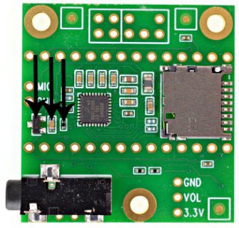

Awesome thanks Paul! I'm not great at reading schematics. These look like they would be critical for outputting audio from the sd card to the line out, correct? I was kinda hoping they wouldn't be necessary for my project, but hopefully I have...
I tried to remove the 14-pin female header I soldered onto the shield with a hot air station, and in the process, these three components were desoldered and lost. It looks like it's two resistors and possibly a MOSFET? Does anyone know the...
