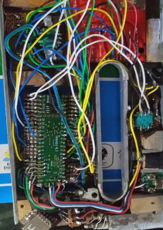

      I tried changing the sequence of functions in void setup() and also change AudioMemory(40); like this.. void setup() { Serial.begin(57600); kpd.setHoldTime(1500); if (!SD.begin(BUILTIN_SDCARD)) {...

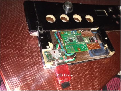

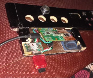

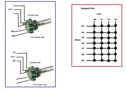

      Thankyou....paul Encoder wiring is this way. I have same this encoder.my sd Card is SanDisk ultra fast 64 gb card is working fine. Problem occurred only when I add rotary encoder's code to my main code ,as you are seeing in Post #1 codes. I...

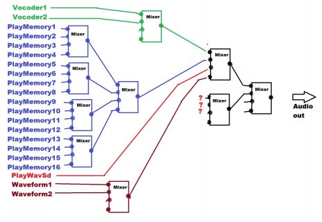

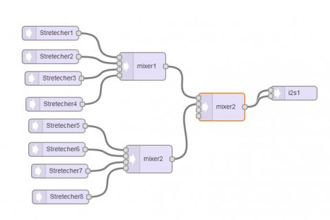

      I mean, no more than four stretchers will be call to vocoder.play(); through the mixer simultaneously. I can only work with four or so at the same time.The remaining stretchers will remain stopped until further inputs are issued. something...
    • C
      If we want to load a new sample with New size into the same stretcher, do we need to clear the stretcher memory first? If yes.... What function should be called???? If no more than 4 stretches are run at a time .Considering the psram capacity...
