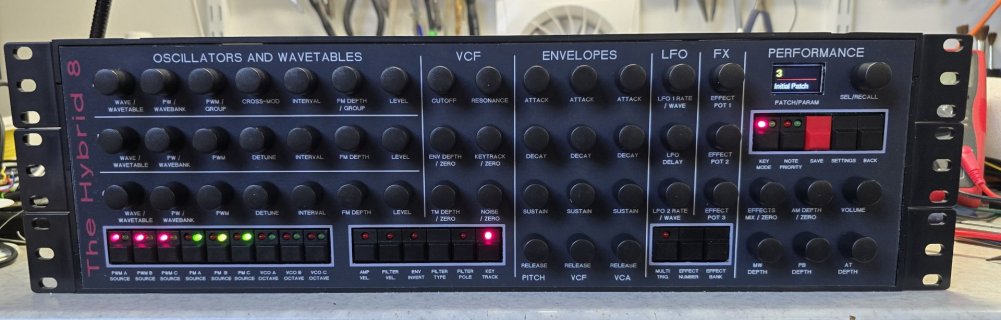

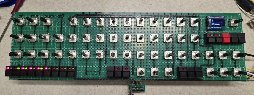

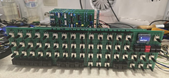

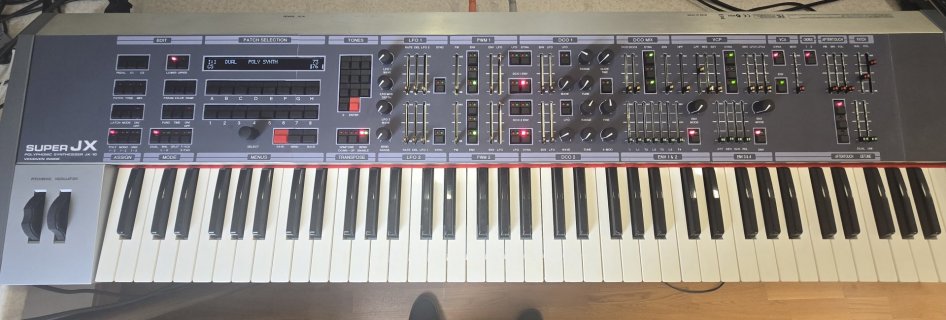

      In this project I wanted to control a Roland Super JX-10 with an editor, but I didn't want two displays and duplicated controls. The JX-10 and MKS-70 have an internal assigner board, it's the heart of the synth, it basically controls every aspect...

      With an mcp23017 you can add 8 encoders on 2 wires. Upto 8 chips for 64 encoders, 128 buttons or leds

      I always use RK-09 10K pots of some type or other when I build with pots, my current project is using sliders and pots and I get a little jitter just on two of them at mid way point, a bit annoying as these are tuning related pots. Anyway I moved...
    • C
      If you use encoders and lose the sliders then you can get a really stable interface, I used to use pots all the time, upto 128 in one project, noise is always a problem. I try to use encoders attached to mcp23017 chips now, it just uses 2 lines...
