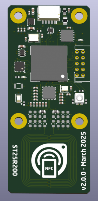

My company GoToTags, makes NFC encoding robotics and software. We got to the point with off the shelf NFC readers that they couldnt meet our performance goals, so we decided to make our own. We worked directly with STMicro engineers on the board...

Thanks for taking a look Paul.
I'm not sure I understand your comment. Are you referring to the 5V-3.3V LDO? If so it seems well able to handle the current as its rated to 1A. The part is NCP692MN33T2G...
Im building a custom board based on a Teensy 4. We heavily use the Teensy 4.0 and 4.1 in our other projects but for this project we need a very small form factor and a limited number of exposed pins to talk with another chip via SPI and a couple...
