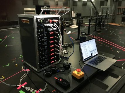

      Sorry for my late reply. My memory of seeing this is that it was the orange light near the button and that it was blinking at around a 1 second cadence. That's about all I can say. Hope that helps narrow it down a little.

      Yes, the program was working. Suddenly it wasn't. Part of his debugging process was to power cycle everything, and after that he noticed the blinking light. It's possible that was happening before the reboot, but I don't know.

      I wasn't there when it happened. The description of what happened from my colleague was that it was working normally, he issued commands to it over the USB serial port, and the Teensy stopped responding. He tried rebooting it and saw the...

      The enclosure in question:

      Yesterday I experienced something odd. Two years ago I built a motor control system using a Teensy 4.1. It's inside a closed cabinet, but communicates with a laptop computer over a serial port to receive commands and send acknowledgments via a...
