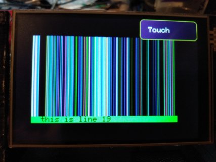

I have completely fixed the scrolling problem I was having.
I found an other ScollTest example for the ST7735_t3 library that had the proper use of the frame buffer in it.
All that was needed was to enable the frame buffer before the scroll...

Yes, I tried all 4 directions on this and it did the same thing.
I think I may have a fundamental misunderstanding of how scrolling works on this display.
The bottom line works and updates correctly.
I may be able to think of a way to go around...
I was trying out the scrollTest example that is part of the ILI9488_t3 library and it generated color bars as soon as the text gets to the bottom of the screen.
Attached is a photo.
I am new to coding but usually can get an example to work right...
