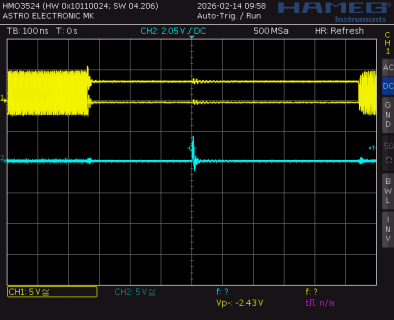

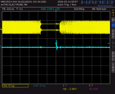

It seems the interrupt vector doesn't point to my ISR, but to some other code that's executed before and after my ISR. Is it possible to avoid this extra code? I think I must also clear the interrupt bit in my ISR then. Is there any example for...
In this example for Teensy 4.0 I'm using a 200kHz timer interrupt to generate a short pulse at pin D1.
In the main loop pin D0 is toggled as fast as possible, so that I can see on the scope the duration of the interrupt.

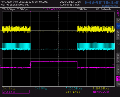

In this example for Teensy4.0 I have two timer interrupts with 200 Hz and 200 kHz, and I want the 200 kHz interrupt to have the higher priority.
But as you can see in the scope screenshot, the 200 Hz interrupt has higher priority. Yellow is D0...
