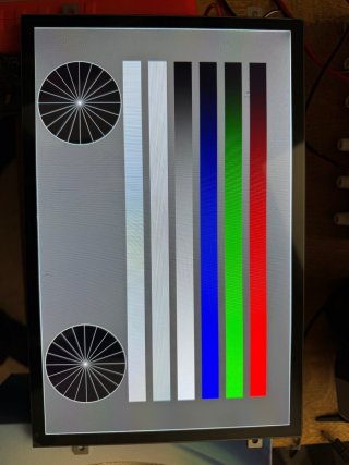

Testcard with updated library works well - see attached.

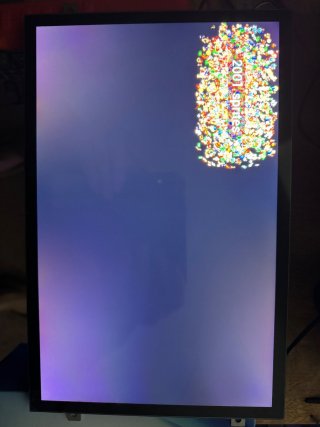

If by artifacts, you mean unexpected flashes outside the area where the sprites are, then no. The Teensy gets to the 2001 counter very fast so I put a delay in the main loop to slow it...

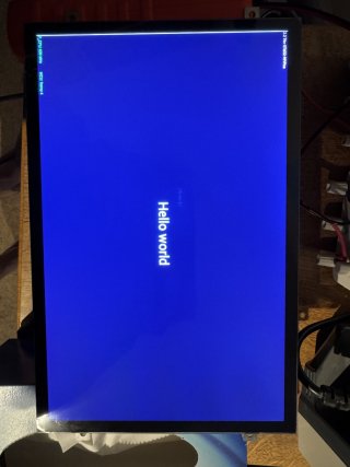

A while ago, I was configuring the library to connect a 10.1" EVE4 display. However, due to time and resource constraints, it wasn't possible to get the display for testing. Since you already have a 12.1" display, if you'd allow me, "you'll be my...
Awesome, thanks TFTLCDCyg!! I had to change the reset pin in your .h file to 3 as the Teensy doesn't have an (easily accessible) pin 24. Your Hello World example now shows Hello World. There is a white border along the left edge but no other...
