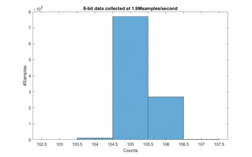

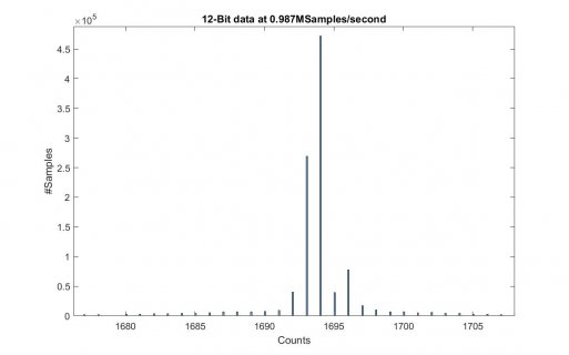

* The recorded 12-bit data has about +/- 20 LSBs of noise. I suspect that most of it is in the 3.3V reference,
since my test input is a 3.3K resistor from a digital pin to the ADC pin with a 10uF cap from the ADC pin to
ground.
I found that I got pretty impressive sampling speeds with the T4.1 clock at 600MHz:
12-bit conversion, High Speed ADC clock, Medium Speed Sampling: 987,354 samples/second

8-bit conversion, Very High Speed ADC clock, Very High Speed Sampling: 1,875,806 samples/second

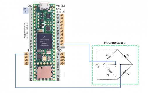

2. Add a second ADC channel on ADC1. Save that data instead of all the timing intervals. The IRQ
handler will just record the maximum and minimum intervals between interrupts.
