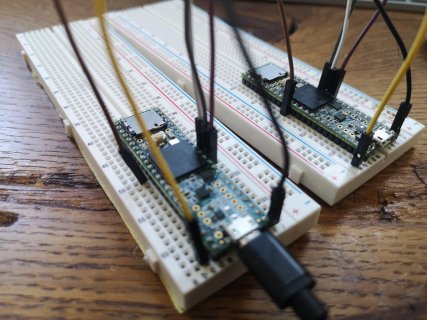

Hi everybody!
I'm experimenting with SPI and trying to make two Teensy 3.5 communicate with each other. Im using the tonton81's TSPISlave library. But somehow I just can't make it work.
This is my wiring:
![IMG_20200501_132920.jpg IMG_20200501_132920.jpg](https://forum.pjrc.com/data/attachments/17/17608-9375e8e309b58cae88a4cbfb5f8e8b51.jpg)
Master -> Slave
Vin Vin
GND GND
10 10
11 12
12 11
13 13
Master Code:
Slave Code:
The only output I get is "0". Any help would be highly appreciated.
Thanks in advance!
