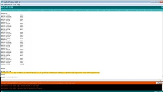

I am trying to get an open source 3D printer software called Marlin compiled using Arduino 1.0.5 IDE for Teensy 3.1. Here is the link to the software: https://github.com/ErikZalm/Marlin
I downloaded the Teensyduino add-on for the Arduino IDE and I am running on Windows.
The Arduino Sketch was intended for Ardunio Mega 2560 and it compiles fine. When I tried to compile it for Teensy 3.1, I got the following error:
So, I tried to add pin definitions for Teensy 3.1 to the best of my abilities...
I modified fastio.h by adding pin assignments for Teensy 3.1 (I refferred to the pin assignments for Teeny++ 2.0 which were already defined in fastio.h):
I noticed that in Configuration.h, there are a list of Motherboards you can choose from and Teensy 3.1 is missing:
So, again using Teensy++ 2.0 as a reference, I tried adding a new "MOTHERBOARD" defintion for Teensy 3.1 in pins.h.
When I try to compile with these changes, I am still getting the same error:
I am wondering if there is something I missed. Thanks for your help!

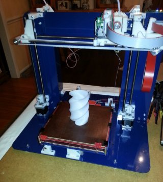

I have an open source Mendel90 3D printer kit that was designed by NopHead.
Like Paul, NopHead (Chris Palmer) is fully committed to open source.
It's an ideal platform for modification and testing.
Here's a link to my build blog: http://mendel90.blogspot.com/
Here's a link to nopheads website: http://hydraraptor.blogspot.com/2012/12/mendel90-updates.html

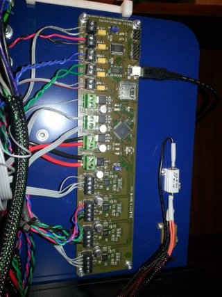

It will take some effort, to develop the interface between the Teensy 3.x and the printer, as stepper motor, fan and heater controllers are required.
My current controller (Melzi) has the arduino chipset, motor controllers and heater controllers integrated into a single board.

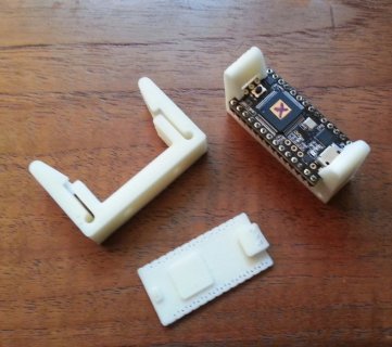

a few photos are attached, showing My Mendel90, a sample 3D printed teensy and teensy holder and the Melzi controller.

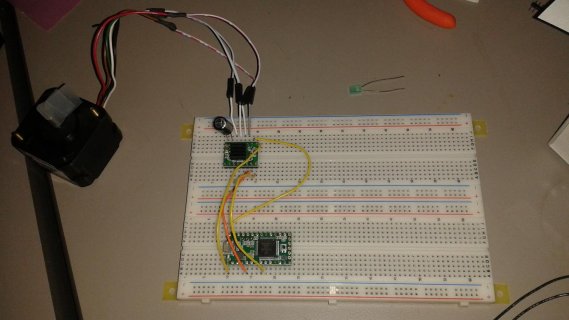

Hi guys,
I didn't have much luck trying to get the stepper motors spinning using the Marlin code. So, I am trying to use the AccelStepper Library and the sample program that Paul has here: https://www.pjrc.com/teensy/td_libs_AccelStepper.html
I tried this sample program just using the Teensy, the stepper motor and the stepper driver and I can see the motor spinning (see above).
However, when I tried adding the RAMPS board, I couldn't see the motor spinning and here is my setup:
I have the stepper driver and the stepper motor hooked up to the RAMPS board. I connected 12V to the RAMPS board to power 'Vmot' of the stepper driver. I also have connect X step and X dir from the Teensy board (pin 3 and pin 6) to the header on the RAMPS board where those signals are routed form the stepper driver. I have Vin from the Teensy connected to Vdd on the RAMPS board and also GND from Teensy to GND on RAMPS. When I powered both the USB on the Teensy and the 12 volts from the power supply, I couldn't see the stepper motor spin. Any thoughts?

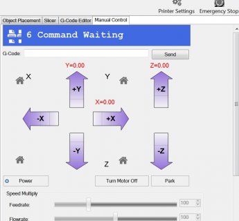

Yeah, when I tried to send a command using Repetier Host, I keep seeing x "commands waiting" under the manual control tab... Do you see that too?

Hmmm.... I wonder if we are using a different version of Repetier host... because I don't see the "fake ok" button. Or maybe I am missing it.
Here is what I see:
Also, when I connect to the Teensy board using Repetier Host, I keep getting a number of "Commands Waiting" at the top... have you run into this by any chance?
I am using version 0.95F
Here is what I see:
Did you scroll down completely?
Same here, but with "Fake OK" the waiting commands were sent.

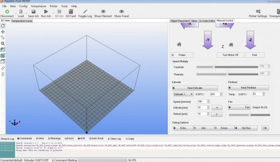

Yes, I scrolled down completely. Actually, I don't even have the "Print Panel" tab. It seems like the Mac version has that feature but not the windows version...
"Print Panel" is now "Manual Control" and they removed the "Fake OK" Button... There is no development of the mac-version! |-(
I tried the Linux version. It also has only "OK", not "Fake OK", but it seems to work fine.
I had to edit the baud rate to 57600 in Configuration.h. The Linux driver doesn't seem to like 250000 (even though Teensy 3.1 complete ignores the baud rate).
Repetier-Host does seem to be getting hung up on something and requires the "OK" button clicked. I believe it's due to the missing temperature feature. The blue bar will stay stuck as "1 Command Waiting". Clicking "OK" gets it unstuck.

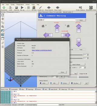

Nikki, as a first sanity check after you click "Connect", use the menu Printer > Printer Information, to see if your Teensy 3.1 is responding at all. You should see Machine Type = Mendel, Firmware = Marlin, and Firmare URL = https://github.com/ErikZalm/Marlin/
Here's roughly what you should see.
(click for full size)
This first Printer Information step means you've got a connection. There's no point trying other stuff like moving the motors until you at least have a connection.
Once I got it connected, clicking the X-axis arrows on the Manual Control tab did result in pulses on pin 0, and the direction does change the voltage on pin 1. Clicking "OK" regularly to get it unstuck is needed....
Obviously quite a bit more work is needed here, but at least it's partially functioning. :)

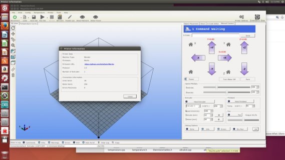

Hey Paul,
Yes, I am using the correct COM port. Repetier throws a connection error if I select the wrong COM port. When I first click Connect, I am still seeing "unknown" in Windows...
However, after clicking the "OK' button, Repetier was able to recognize Teensy. I am seeing what you described:
So, it looks like I need to connect and then press the OK button for Repetier to connect to Teensy.

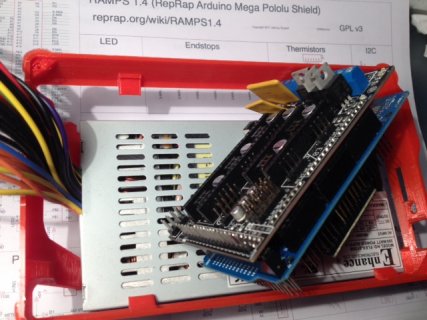

Little progress
Little progress with my Teensy 3.1 to Ramps 1.4 adaptor using:
- Teensy 3.1
- Tall Dog LLC Teensy 3.1 Breakout
- Arduino Mega Protoboard with stackable headers
- Ramps 1.4
- ATX power supply/Felix frame
