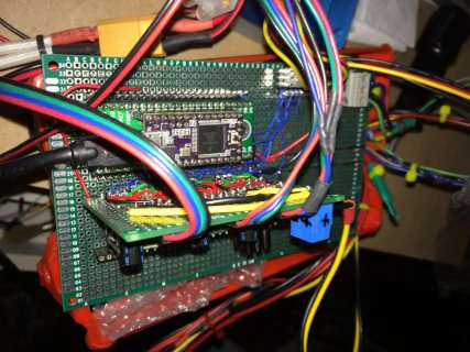

Little progress with my Teensy 3.1 to Ramps 1.4 adaptor using:
- Teensy 3.1
- Tall Dog LLC Teensy 3.1 Breakout
- Arduino Mega Protoboard with stackable headers
- Ramps 1.4
- ATX power supply/Felix frame
Hello I was wondering if you got this going yet ?
If so do you have the pin assignments?
Thanks Stan
Thanks Stan

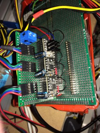

I am stuck, because the ATX power supply doesn´t work. :-(
I did a first pin assignment ... on paper. Because i need two HCT245 and there is little space on the board, i may change some pins.
This is my current(!!!) definition for board 85 in pins.h:

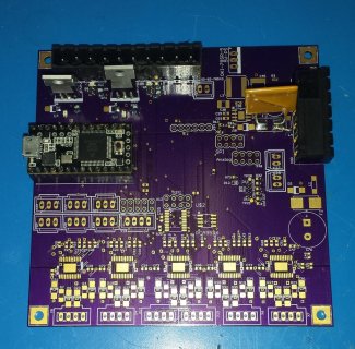

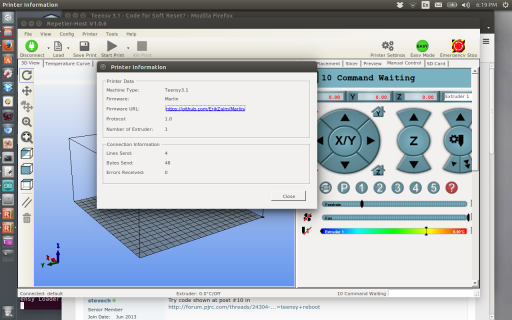

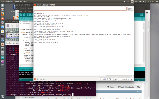

Has anyone worked on porting the temperature code?
I haven't had any time for this project in the last 2 weeks, and with my focus on SPI transactions for the next several days, it may be another week until I can look at Marlin porting again.

Hey all, has anyone gotten any motors to move with Marlin and Teensy 3.1? The code compiled and I changed the pin assignments to match with my setup but the motors wouldn't move. I have basically a functional printer with Teacup and Teensy but I would like to get Marlin ported over to Teensy :)
EDIT: Just got the motors to work!! Now on to the temperature porting. Paul, have you had the chance to look at this again?
Congratulation!

First send M119, it will show status of all your endstops, make sure that inverting(X_MIN_ENDSTOP_INVERTING) is set properly in config. After this you should get movement in at least one direction for each axis, then you can home an axis by ie. "G28 X0" for x, I recomend homing one axis at a time at first, chances are you have inverted some steppers direction or some endstop is not correctly plugged or something, so be prepared to pull out the plug... If you don't have "all" (3) endstops, you can try disabling "min_software_endstops" and "max_software_endstops" (set to false)..

Baseboard with teensy 3.1 on breakoutboard:
Baseboard with first stepper-driver-modul

Teensy 3D Printer
Your board looks very interesting. Are you targeting a particular firmware?
Yeah, I really like marlin. Aside from the predisposition towards atmega chips I really like the firmware and want to get it working with a teensy. Its basically a RAMBo board with the main chips swapped. I also changed some of the packages for ones that are easier to hand solder. Do to the limited pins on the teensy I moved all the stepper enable pins to an I2C GPIO expansion chip. I also left the SPI digital pot for the motor currents, I really like that feature.
Michael,
your board looks great I would suggest to add two things not available elsewhere:
- Place for two more stepper motors to drive four extruders, so it is possible to use E3D Kraken or to do something like the color mixing demonstrated here
- The possibility to use at least one Thermocouple instead of Thermistors, to print materials like PEEK above 290degC
