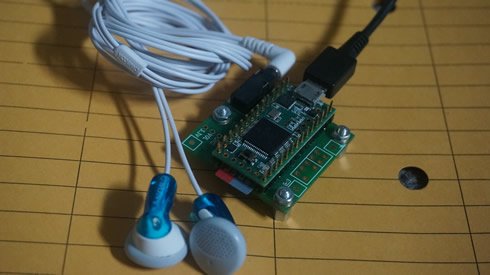

Ok kind of stuck at the starting block. At an impasse for way too long. Have a dedicated 2.0 handling MIDI from DAW to effects processor kicking so much butt, the Audio Board would open up so much right now.
Can get 3.1 to Blink and SerialMonitor sketches working, read 3.3v on the volume header with multimeter.
ToneSweep seems to run, but no sound heard in headphones.
SDCardTest gives "SD card is not connected or unusable :-(" everytime with several different SanDisk Ultra Class 10 SD cards.
WavFile Player => "Unable to access the SD card".
Arduino 1.6.1 & Td 1.23, Windows 8. Help, probably a simple step missed, or maybe I killed it? Have a nice weekend.
If you are just trying examples and having no fun then it must be your connections, can you post a picture of how you have connected the Audio Adapter to the Teensy 3.1?
like so:
Your extra lores pic doesn't make me sure that I can see whether or not that thing is even soldered appropriately, or are those pins meant to be interference fit?
Is it fully soldered?
Maybe the problem is Arduino 1.6.1 - one of the versions I didn't even try, till recently 1.6.3 was the only recent version I didn't hear anything stupid about.
Not soldered, going for the 'interference fit' as robsoles called it. Firing up the iron now will report back.
The holes in Teensy are a bit too accommodating (as they should be) to try interference fit with regular header pins, I expect you are going to have much more joy with soldered connections - as I must assume you were hoping to separate the boards at whim; it is a pity (another assumption that) you do not have header sockets (https://www.pjrc.com/store/socket_14x1.html) to solder into the Audio Adapter instead.
Ooooook, it's alive. In my defense the headers were soldered in to the audio adapter, but yea now it's all soldered. PlaySynthMusic and SDCardTest responding, this is fantastic. Thanks and thanks.
