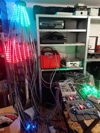

Artnet.cpp and picture
  • Artnet.zip
Your welcome! Anything else? :)
