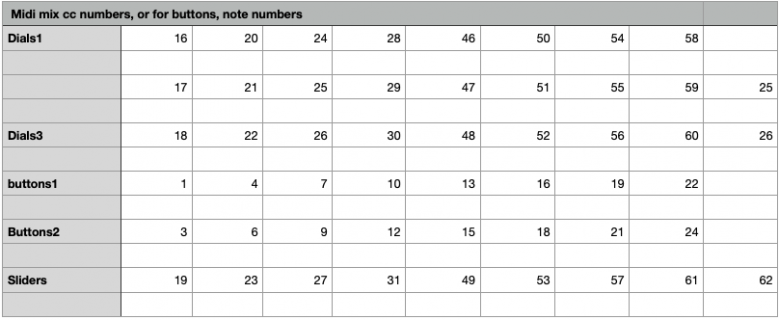

In theory that is. As many other people have found, the illuminated buttons don't light up unless you send a midi note on code, and then getting them to turn off again appears to be impossible.
This had me flummoxed for a while until I discovered that the Midimix uses a very odd way of controlling the buttons.
To turn a button on, you send a midi note on command (midi1.sendNoteOn(note, 127, channel)), however sending a midi note off command (as most people were trying) does nothing!
Turns out you have to send another midi note on command but with a velocity of zero to turn the led back off again!
I've posted a sample code below that works perfectly for interfacing with the Midimix. The toggles array keeps track of whether buttons are toggled off or on, and the dials array keeps track of the values sent by the dials/sliders.
The serial commands send the midi input values to the serial monitor so you can check k the midi mix interface is working, this can be removed later for optimisation purposes.

to access a midi cc, just use: variable = dials[dial number]
to check a button status, use: variable = toggles[button number]
Below is a chart showing the midi cc control number / note on numbers transmitted from the Midimix
I hope this is enough to help anyone who wants to try out using a Midimix to control their teensy projects :)
