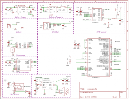

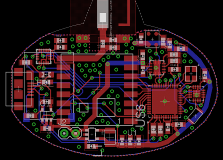

I have attached my schematics and board layout. I would appreciate it if anyone has any ideas about what to try next.

Yes, there is a GND copper pour that is hidden in the picture which connects to the bottom pin and the chasis of the conenctor. The ID pin is floating.
Here's a picture of the board with the Grounds poured, it makes other signals harder to see but the ground connections are now visible

Looks like we're not seeing whatever's wrong from only these diagrams.

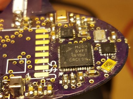

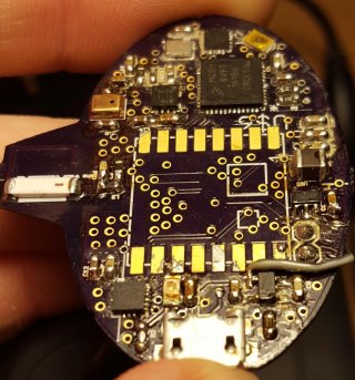

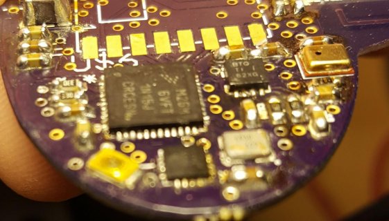

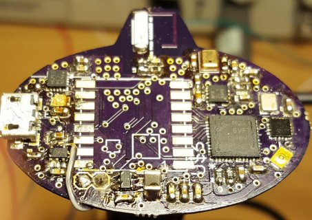

Sure, it's totally worth a try. Here are some photos of the board at different angles. The gray wire is bypassing the battery charger and connecting VUSB directly to the input of the 3.3V switching regulator.

Just looked it over again. Sure seems like it ought to work.
Maybe something's just not soldered quite right? Those pads under the chips look like they come very close to the pins. Did you get any solder mask between the pad & pins? Perhaps one or more pins could be shorted to ground underneath either chip?

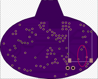

OMG I found it!!! Thanks for the tip Paul. There were no ground shorts, but probing EVERYTHING helped me find a MISSING TRACE on one of the usb signals. The board had a trace jsut deleted from it! UGH! I must have hit the delete key jsut before saving the board.
A little blue-wire and an exacto knife and it's alive now!!

Yes, it has ERC and DRC. I believe they do check for unrouted wires. I think what happened was I ran the checks, they passed. I then accidently hit the delete key while that wire was selected. Then I saved. That's the only way to explain it I think.

I just checked the ERC (and DRC) tool on the old PCB file and it did NOT find the error.
I think it would be good to know how to find this type of air-wire error in Eagle.

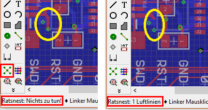

Just FYI, there is a simpler solution to detect missing wires ("airwires") in Eagle.
Click on the Ratsnest button and the status bar shows the total number of remaining air wires.
Nichts zu tun = nothing to do
1 Luftlinien = 1 airwires
