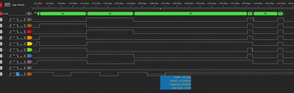

I am trying to program an EEPROM chip with Teensy 3.6. The EEPROM is: Microchip SST39LF040-55-4C-NHE.
Here is the code which also shows which pins on the teensy are connected to what on the eeprom (ardunio IDE on windows).
So A0-A7 is using pins 0-7.
A7 to A17 uses pins 14-23
And A18 uses pin 39
D0-D7 use pins 0-7.
WE is pin 38.
OE is pin 37.
CE is tied to ground (active low, so its always enabled).
I have used this same code with an arduino mega (hence the #define for switching the pin numbers). When I run this on a mega with a Microchip SST39SF040-70-4C-PHE which is effectively the 5v version of the above chip it works and returns:
Also a logic analyser trace: (0-7 = D0-D8, 8=RD and 9=RW).
I've got a couple of other spare EEPROM chips and they all result in 0xFF being returned for the product and manufacture id. I would appreciate any clues on what I could possibly do to try to debug this. Hopefully one of the pins I've used on the teensy is perhaps reserved or something?
